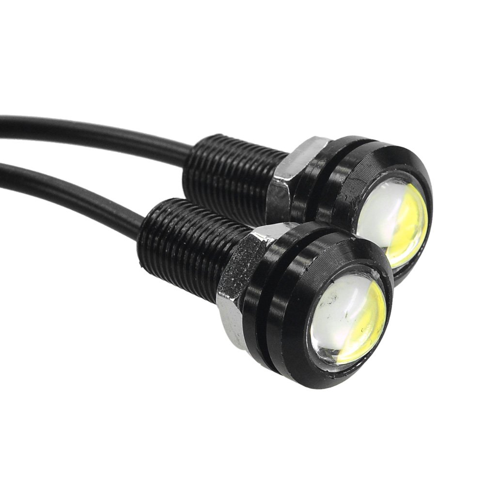

So I decided to fit some Daytime Running Lights, but was spoiled for ideas.
This one started off a possibility but stuck out a bit far so was scrapped:
So I decided on some of these "eagle eyes" instead
Originally I fitted two per side in the blanking plate by the fog light,
They were bright , even in daytime as can be seen here:
Anyway my son G8JKA copied me.... :wtf: but fitted 3 per side and made his flush, so I was not happy..
But, after stripping them apart and fitting them flush, mine are now like that too....
