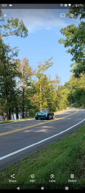

I still have plenty to work on, but given the season is coming to a close I'm going to enjoy the he car for a while. It's on the road!
I'll post a few more pictures and videos when I get the chance. Feels good and sort of surreal that I've gotten it this far :)
Thanks!
I love that colour. It's great. And the wheels are superb.

Nice motor ! Great colour. I rather approve of the ZGT roadster. Nice proportions and quite unique while harking back to AM influences.
I bet it is surreal. You should feel very proud. Onto the new MOT and V5 renaming if you haven't done so already 🤪

Amazing colour and the finish looks great, did you leave the engine bay red ?

I will admit I wasn't keen on your ideas for the car to start with. I will also admit I thought the colour choice was bizarre. But.......
I have changed my mind. The mix of old and new works really well, especially with the bold green colour IMO.
I admire how you sprayed it yourself; despite it obviously being challenging. I would never attempt that.
I like the fact that it is not pretending to be something it isn't. It is just what it is and does a great job of it. Well done, Sir. :thumbsup:

Thank you for the kind comments. It feels great to hit this milestone. I still have many hours of fixing/tweaking things and definitely a lot of hours correcting my clear coat.
I found that the fancy new adjustable headlight brackets will unscrew themselves over time. I had a headlight bouncing around on the passenger side bucket. Thankfully that's not a big deal. I'll either add threadlocker or a jam nut to the bolts in the future. For first time out shake down issues that's not bad, not bad at all.
@Duncodin Registration is different by state. Being in Michigan I may have to change the title to a kit car title. In other states I may not have to do this. Being a "classic" car it also allows a lot of legal exceptions so I have relaxed laws there as well.
