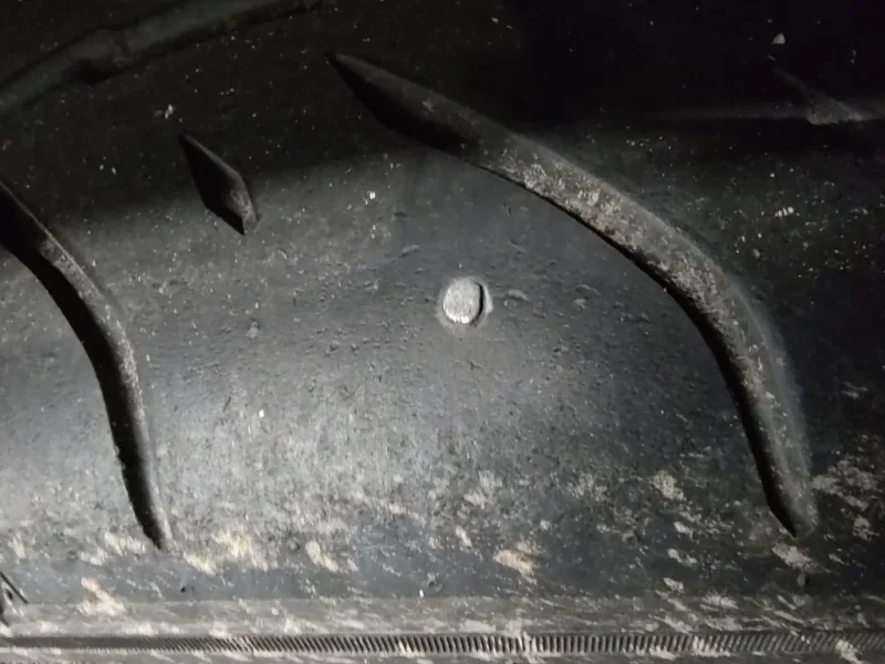

More headlight work! Since I bonded the bezel to the body, it was time to get rid of the original bezel inside the headlight bucket. I needed to clean it up in there. Created a LOT of dust in the process. I was still wearing all of my PPE, but I'm really glad I installed a ceiling mounted air filter. A HUGE difference. I took before and after pictures but you can't really see it.
This bezel has been obliterated. Now it's just the bonded bezel...
