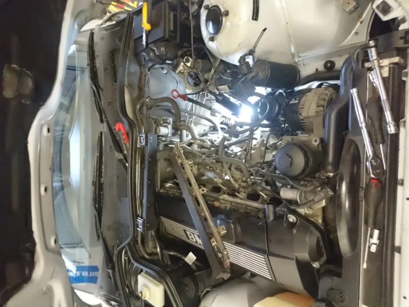

So after @Daz3 kindly sold me his M50 manifold i headed down to the Zed Shed to get some help in fitting it.
SO after a very enjoyable bacon baguette and cup of tea we got cracking.
@Lee had recently fitted one to @Oldguysrule 2.8 so knew what he was doing and his help was epic
after a couple of hours of taking it slowly we got it all fitted up and working.
a brief moment of disappointment as the car was idling high, but only turned out to be a misaligned throttle cable.
the test drive even in the p****** rain was amazing, the car is so much more responsive and very very quick!
old manifold out
new one in
After that we plugged the car in, deleted some old error codes and topped up the brake fluid
