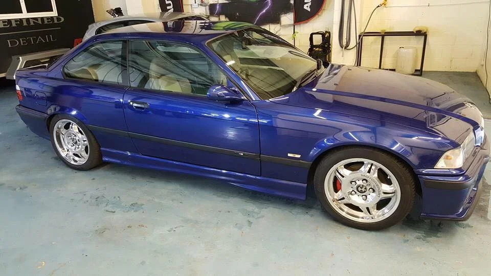

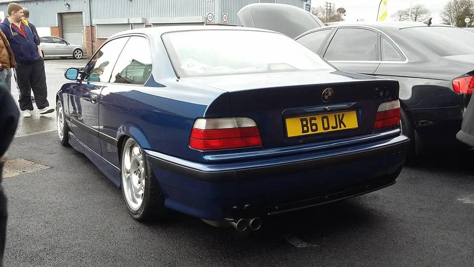

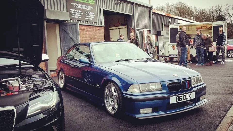

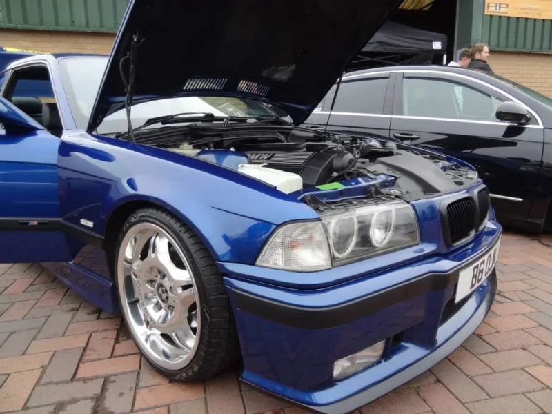

so this is really exciting for me. I've finally got the Style 24 wheels refurbed and mounted and i'm completely over the moon with them.
I started the refurb myself but quickly realised that was going to take far too long. a quick trip to MyAlloys in Basingstoke and they are done.
New centre caps from our good friends @Soper Parts Lincoln and some eBay bolt caps and we are good to go.
They are BMW OEM Style 24 which came from a 1995 BMW M3 LTW
These are the rarest style 24s available as they are 1995 only LTW wheels
Forged
Perfect Z3 fitment (Same as standard wheels)
They weigh 10kgs (as a set) less than the originals so some good unsprung weight savings
My tyres are still cheap cack but have loads of tread so not going to waste that
