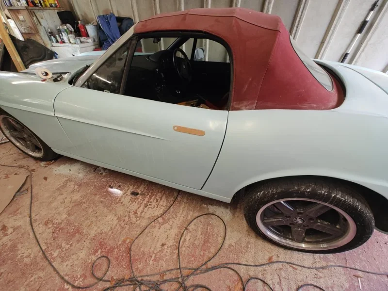

Change of plan, I'm going to wait to see what @argy comes up with. So I've fitted the drivers door skin. Unfortunately this was a bit of a worse fit than the passenger side as to get it to line up with the bonnet you have to lift the front of the door quite a bit so the shutline at the back of the door is more like a triumph and at the front the skin is higher than the existing door so I've had to put something to raise the existing door so that the new skin has something to hook over.
Piran
Oct 21, 2022
41
Lots of sanding and filling to do now and the wing mirrors to add and it feels like I'm almost back on the road

Your driver's door looks OK in the picture. Did you see my picture? It was so far out I had to chop off the swage line and stick it back on half an inch higher.

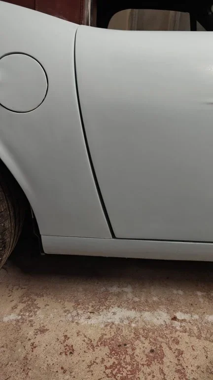

yes I saw yours, mine wasn't that bad but to get it to line up my shutline at the back is not exactly even
I had similar issues so used the swage line as my datum point and built up the top of the doors to match the height of the clamshell. I've got 2 sets if doors...1 set with classic mini handles and the other set handle less ready for when Argy's handles are on sale. I've had to build up the height on all of them.
The fibreglass is quite thick there so I ended up grinding a little off of the edge of the door skin and rear tub to get a fairly even shut line. Only needs a couple of mm each side.
But you also have a couple of mm of the old door sticking out in places too :(

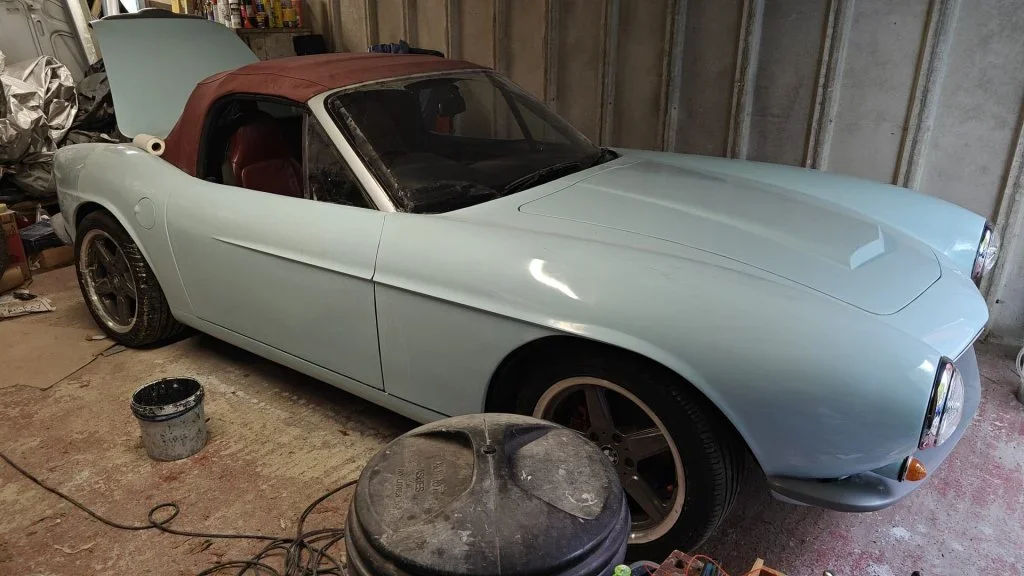

Nearly there, some more sanding and polishing, but wing mirrors on now just waiting for Argy to finish the door handles, some temporary side repeaters for the MOT and off we go, so do I change the registration to a BMW Tribute 507 before the MOT or after?
No. Especially as you can see the front ones from the side. Which is why the Z3 needed side repeaters.

Nearly there, some more sanding and polishing, but wing mirrors on now just waiting for Argy to finish the door handles, some temporary side repeaters for the MOT and off we go, so do I change the registration to a BMW Tribute 507 before the MOT or after?View attachment 301315
Looking really good Piran. Well done.
I fitted my wing mirrors, then took them off again as I had to build the height up on the wings as there was a flat spot where the mould was joined. Took about 15mm of filler.
The mirrors were more aesthetic for me as you could see bugger all behind you with them 😂.
I've changed my reg for a dateless one. I looked at dateless 507 plates but didn't see anything I liked for my budget.
I've got loads of wet flatting and buffing, then reassembly and mot.
Looking forward to taking it out.
