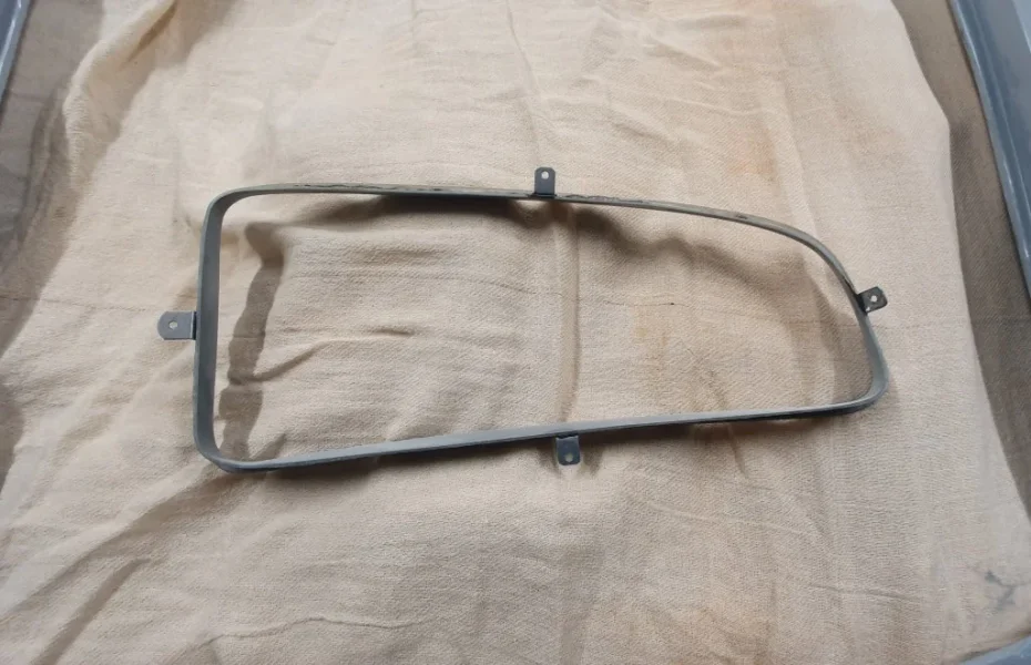

I tiger sealed 4 small 45° angled brackets on my grill surrounds (the type kitchen fitters use for angled base plinths). The mesh is held in place with small plates that fix through the angle brackets into the bodywork. I'm going to try and wrap the chrome work 😎
Brackets like this?

For my grilles I drilled a hole bottom and top centre, and used a metal tab on the rear to lock the grill in place against the rear clam.
the mesh is stuck to the rear of the frame by tiger seal

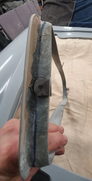

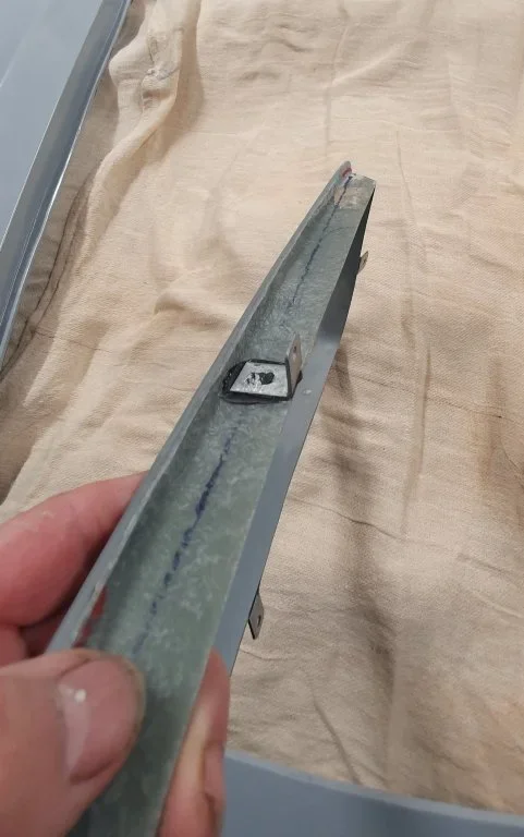

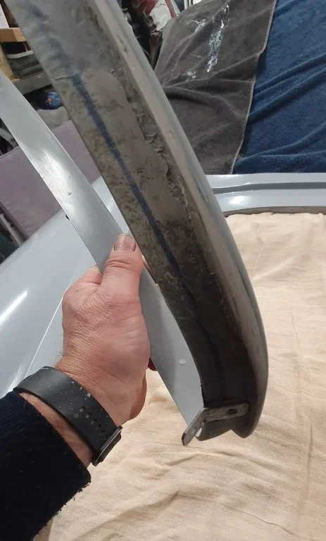

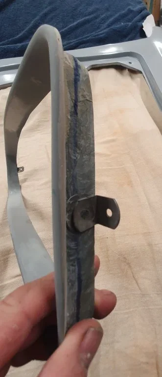

Still working on it. :( I made some brackets:
Which I've tigersealed onto the bonnet, and then I'm fastening captive bolts to the surround:
then I'll just tiger seal the grill to the back of it with little flanges I made. No idea if it will hold but I wanted to crack on so we'll see.
I've just tigersealed round the back where the new body doesn't fit the roof seal, the indicator cowls onto the bonnet and the brackets to the bonnet, will let it set and then fasten the bits to the surround etc.

Well that answered that question: No tigerseal isn't going to hold it on. Tightening the bolts on the captive bolts just pulled them off. back to the drawing board..
