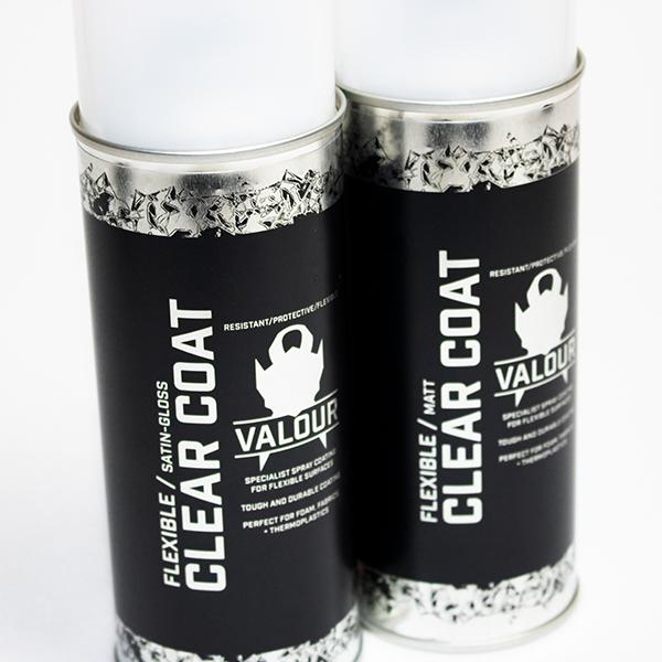

You are probably correct. I covered mine (it was on a Jango Fett helmet made out of EVA foam) with a clear coat that was specific for covering acrylic paint and there were no ill effects.
the paint used was :
