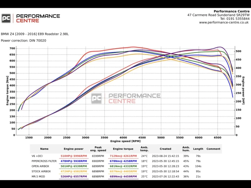

Thnx for the feedback…my 35is is now around 525-545 crank BHP and 750 nm torque ..on 23 psi tapering to 21 psi..with a Quaife lsd and all the Nannie’s…if you let it rip it’s almost mind bending….so I look forward to the Z3 with even more power 👌

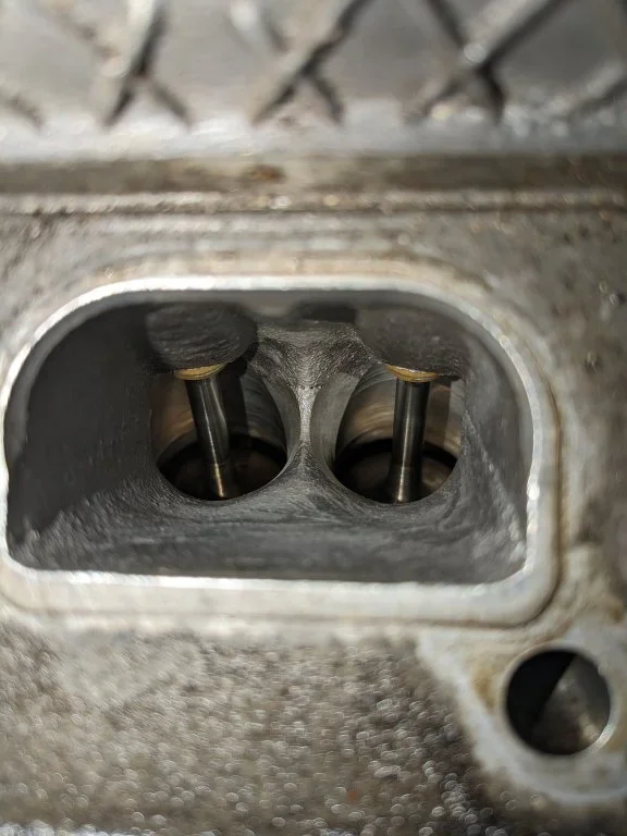

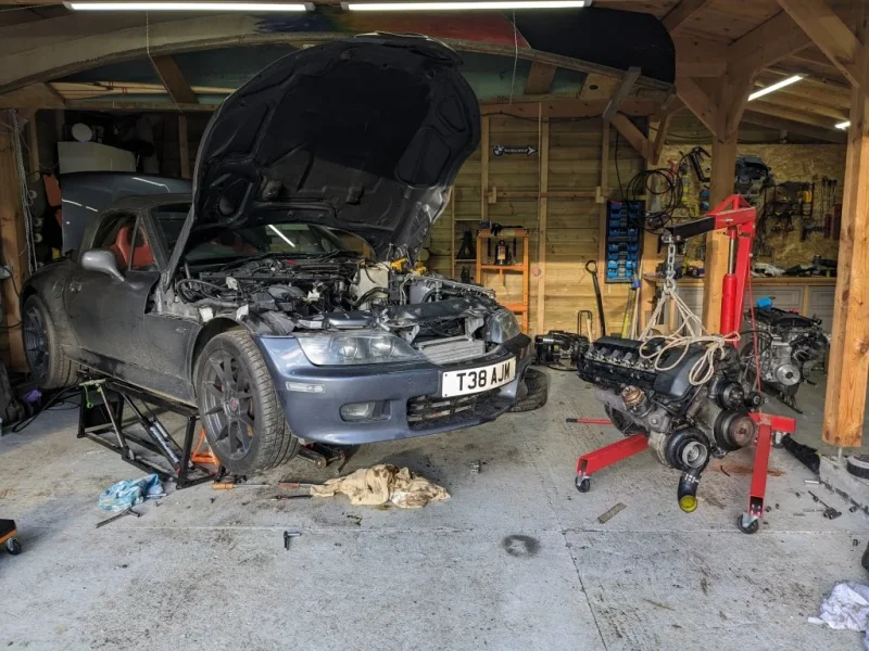

Today was engine removal day. I have worked on this car far to much. From the point it was lifted off the ground it was three hours until the engine was out. Will take a whole lot longer to fit the new one with all the changes.
I was very surprised at how clean the intake valves were. The stock crank vent system was removed when the turbo went in and it catches a lot of moisture and filth. Intake ports are spotless.
Port injection Zeds run a lot cleaner than direct injection Zeds..the N54 is notorious for coking up its inlet’s..the later N20/N55 had better control of the recirculation system so wasn’t as bad…

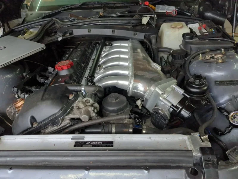

While she recovers I managed to get the new engine in before going away again. Still a lot of work to go as there are so many changes.
The intake clashes with the heater control solenoid and the power steering reservoir needs to be relocated amongst many other things.

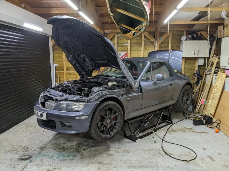

Work got in the way for months so finally back at it.
Super happy yesterday as I got the new pedal and throttle body wired in and working. Lots more to do but that was a big worry.
