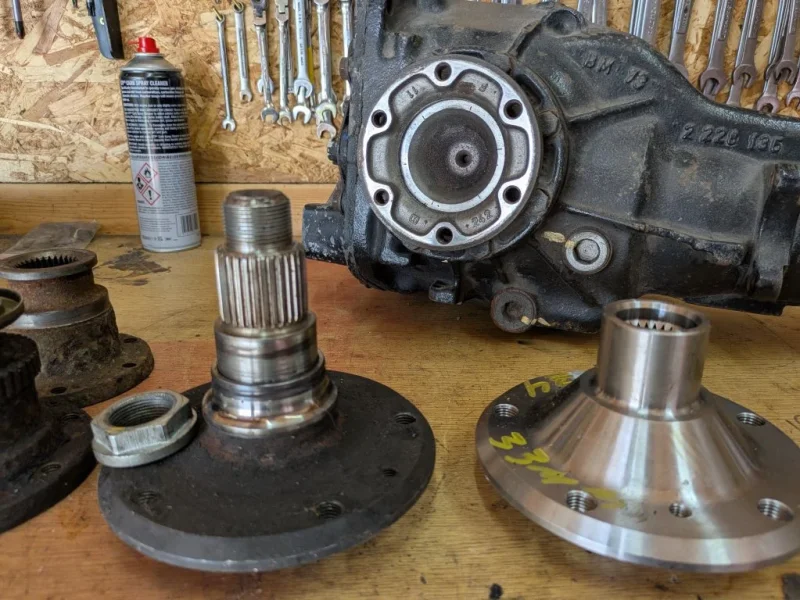

I am running poly engine mounts, single mass flywheel with non sprung clutch discs, no guibo since it's an upgraded prop shaft with larger u joints, twin eared diff cover
Spare wheel was gone when I got the car. Previous owner put quad exhaust on the rear trying to mimic an M.This is a very fun looking build thread ! Maybe one for the future, who knows
I assume with the twin eared diff cover you had to lose the spare wheel carrier?
