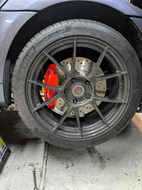

Front brakes fitted. These were pretty straight forward. Adapting the 911 Brembo rears is going to be a bit more work.

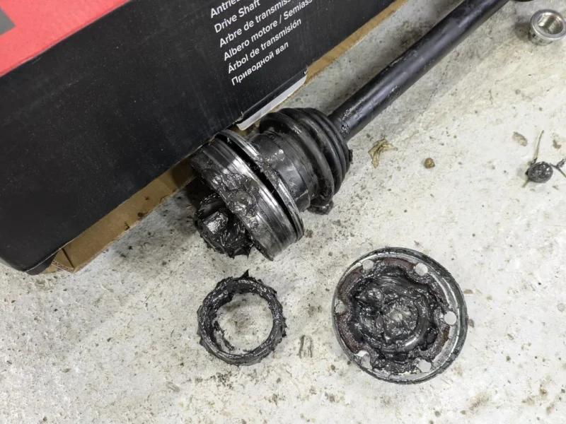

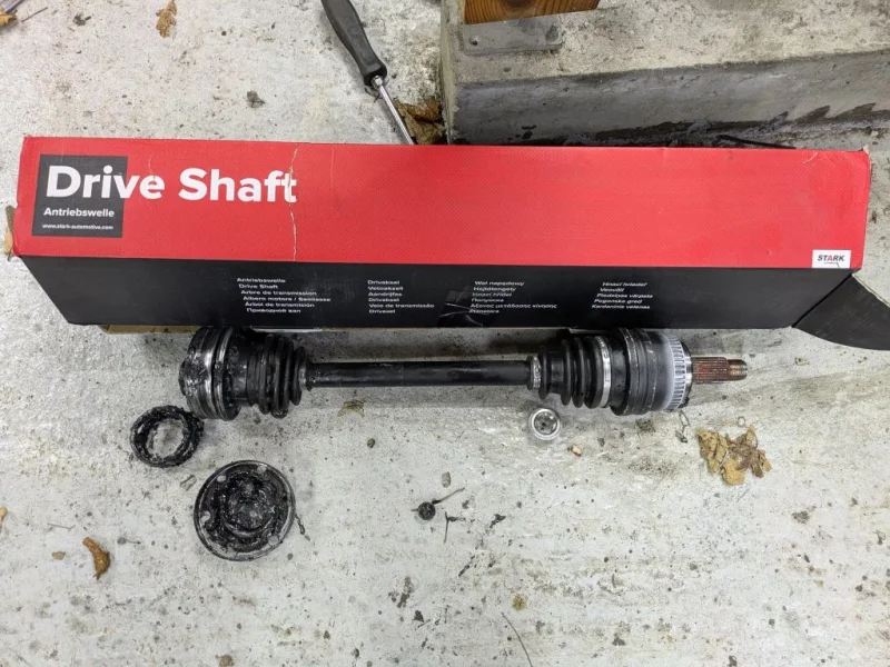

Not a happy bunny this evening after a long walk home in the wet. Broke down a few villages away so could be worse.
Not long ago. Less then a few hundred miles I swapped out the rear cv shafts just because they had a lot of miles and abused. Put in a pair that had decent recommendations. With just basic daily driving the right inner cc joint started making noise then failed all together.
Pulled the car home and the original shafts are back in.
Anyone have recommendations for good quality cv shafts?
Is Stark a tier 1 supplier?
Given the extra strain it’s not a surprise that some aspect of the powertrain fails..on E89s once you get past 600+Bhp half shafts tend to snap if harsh acceleration is frequently executed
There has been no strain on these. The stock ones have taken a beating. The replacements just went in and have made a few trips around town and to work. With the state of the roads in Norfolk and the general weather this time of year any abuse would probably end up at the bottom of a ditch.
I have not cleaned it up and inspected it well but it looks as if the CV joint itself just came apart.

Thought Stark and Ridex were Autodocs ‘own brand’ components. Sainsburys beans are good but they are not Heinz.
Nowt to do with me btw!
That’s a bummer. Some ponies are hard to tame.
I don’t think 'Stark’ are particularly reputable enough to provide parts for cars pushing big power.

Next upgrade is fitting an oil cooler and painting the center top hats of the brake disc.
The Brembos upgrade hasn't seen track time yet but feel great on the road. The Mtech discs do not come coated and the middles have rusted over the winter and look crap. After all the work fitting the calipers and getting everything to work it's a bit depressing.
