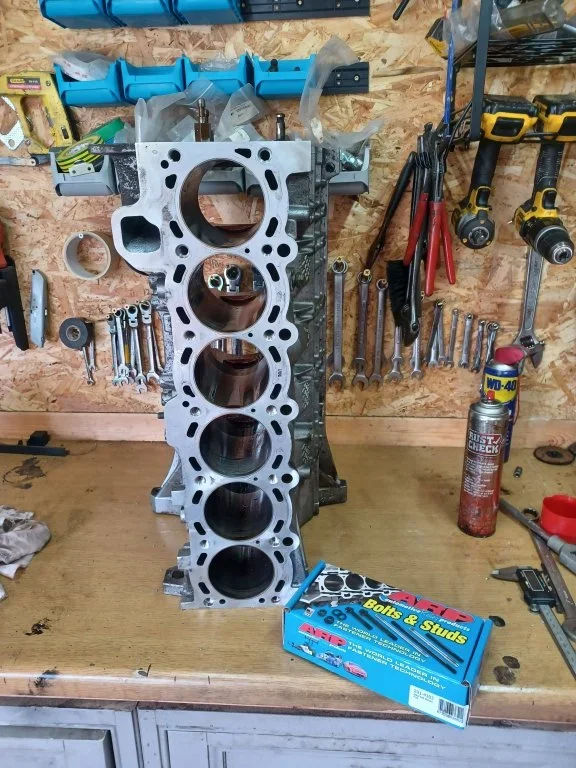

ARP 11mm head studs for the S54. Will also machine the block for thread inserts so they dont pull out of the aluminum.

It may not be pretty now but it has been drilled out for inserts to fit 11mm ARP head studs.

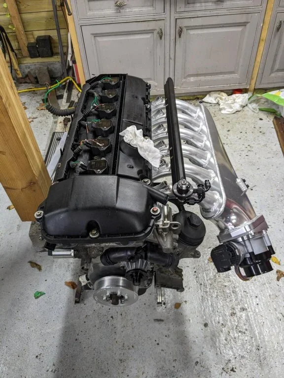

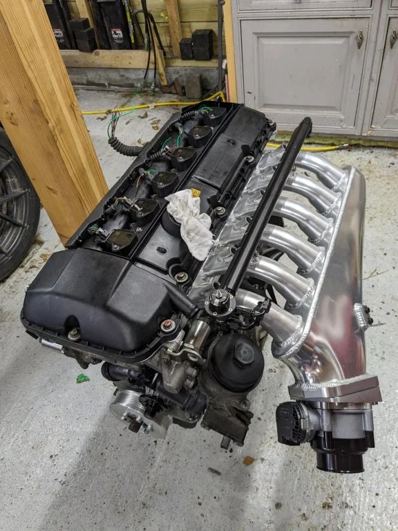

Engine is built and now collecting all the extras. Not much will remain of the first version except the exhaust, turbo manifold and ECU.
Changing to drive by wire to get rid of the idle control valve. It will also have some tuning benefits.
New intake fitted, will require relocating the power steering reservoir.
Will reuse the same turbo manifold but with a new Garrett G30 turbo mounted on it.
850cc injectors should be arriving this week.

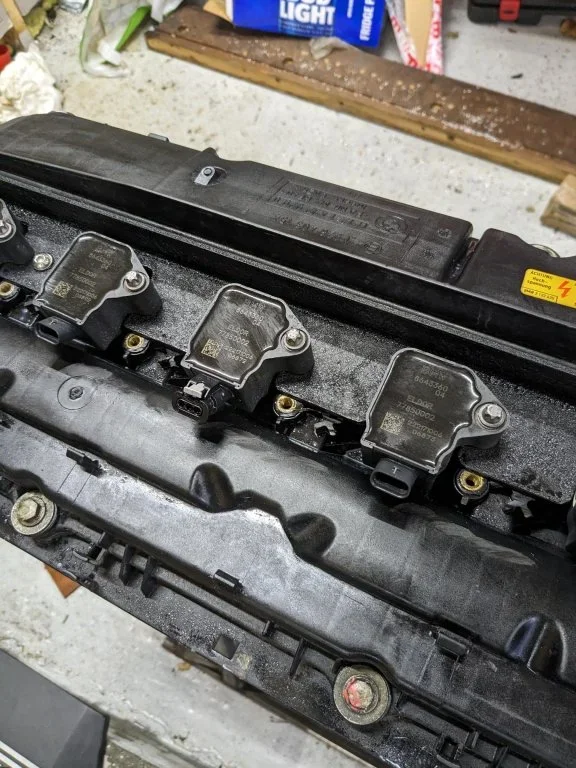

Made a new bracket to fit B58 ignition coils for more spark. Will finish the wiring loom shortly.
