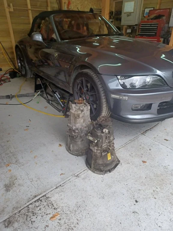

Been working on this car to long. Lifted up and gearbox out in 58 minutes.
Will get the driveshaft away for shortening next week and figure out the rest.

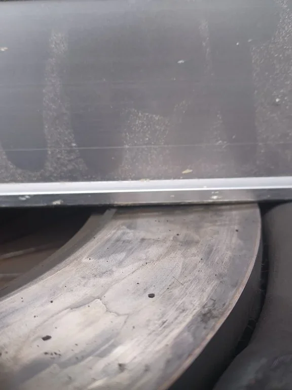

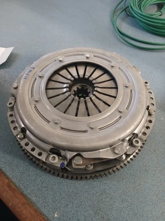

Clutch cover is completely warped. The disc is concave and there is over 1mm clearance on the inside. Besides that it generally looks horrible.
