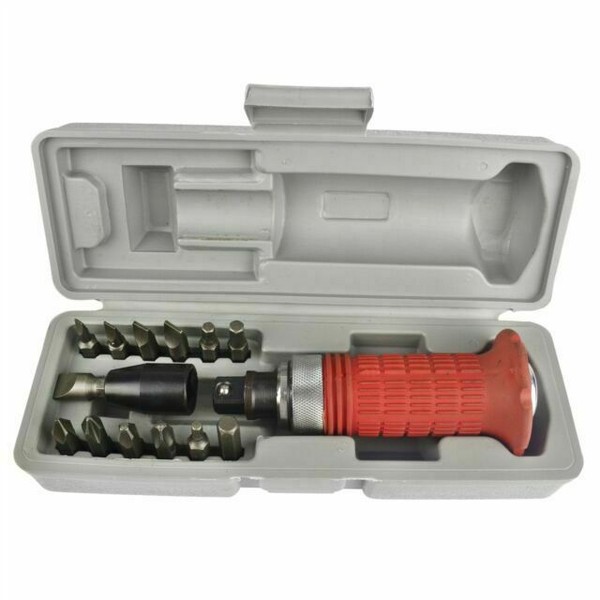

If you have access to heat they come out easy Malc. They're splined into the flanges. It's risky to try knocking them out with out heat if the flanges and pipes are rough. One other way is one I saw either on here or YouTube is to cut a slot in the flange through to the stud, which releases the tightness of the fit and then they knock out relatively easily. If you have an Impact driver set, such as,
Using a Dremmel or similar and grinding disc you can cut a slot in the screw heads in the side brackets and use the big flat blade driver bit in a socket to turn them.

the screws of doom......I have found a impact driver.....( forgot I had it, )... So space permitting, I can put a slot in the head with the multitool, and whack it with a hammer ......Theory good .....=))
If they undo great !! But if the head snaps off no worse off and at least I will be able to drop the beam
