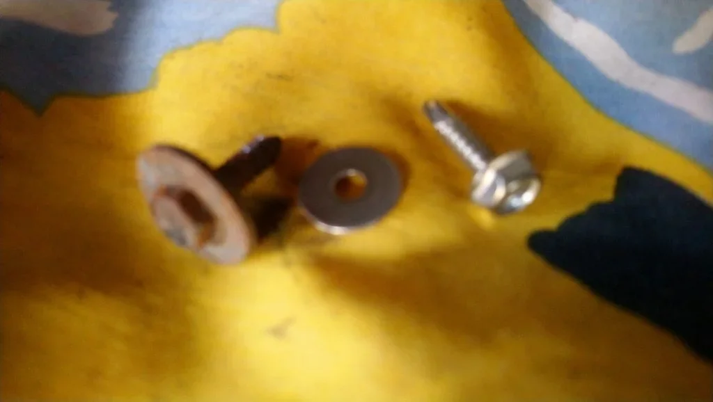

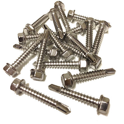

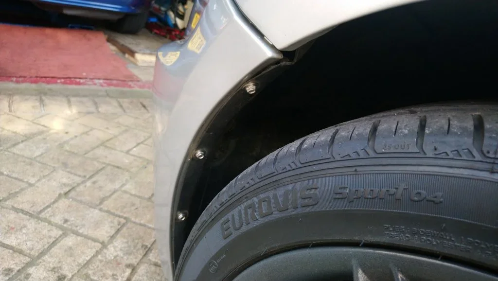

When it comes to replacing all those 8mm screws I have replace them with stainless self tappers with the addittion of stainless washers to increase the head size as the new screw headsize hasn't got a shoulder on them, I used them on the edge of the front wing liner to replace the rusty originals on my Z4.
4.8 x 16mm is original size with the stainless self tappers you might want to grind off the drill tips on them and maybe reduce the length to 13mm when you choose the size. I would have used them when I checked behind the outer sill on my Z3 but replaced a few with oem ones, wish I had used stainless then.
and

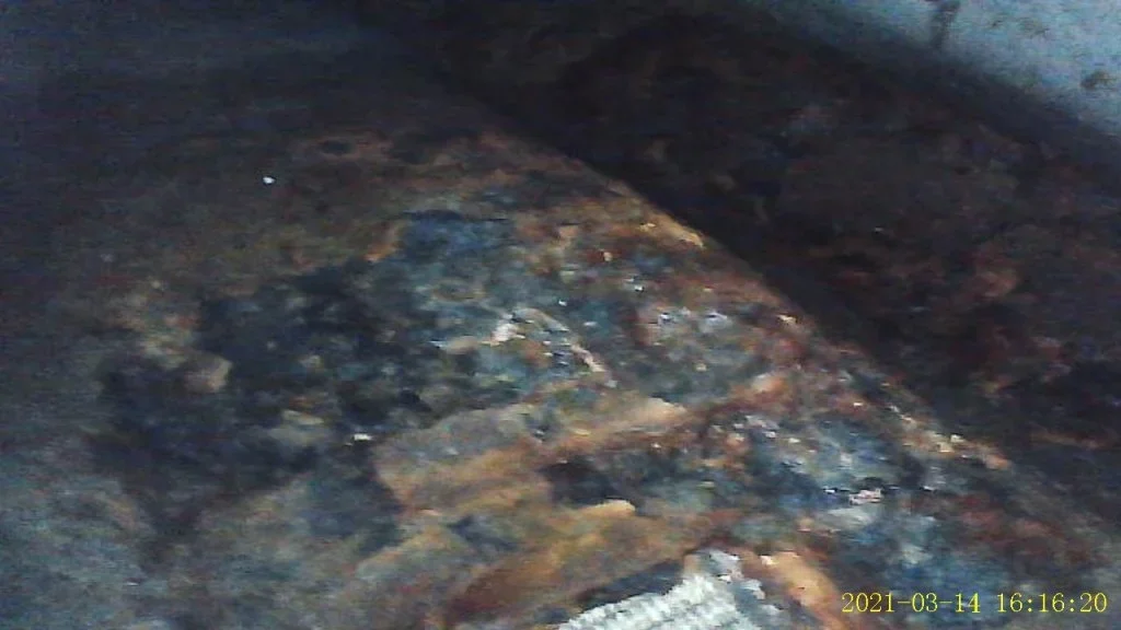

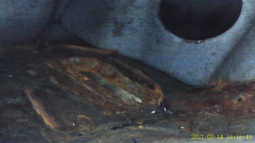

Not actually doing anything on the car but been playing with the endoscope I got as a birthday present ( and no I haven't tried sticking the camera up my bum !!! =))=))=)) )
I have been looking inside the sills around the jacking points etc, and lots of surface rust in there.....
picture quality not to good, probably me not keeping the camera still.
Jacking point
looking out through the jacking point
the end of the sill cavity
jacking point
I will need some kind of spray treatment to make sure its all treated???

What about this https://www.rust.co.uk/product/fe-123-rust-converter-4
Sold in larger quantities.
My inner sills were fine when I checked behind the cover sills, didn't need any converter just applied Clear Waxoyle on the inners and Black Waxoyle on the inside face of the outers.
