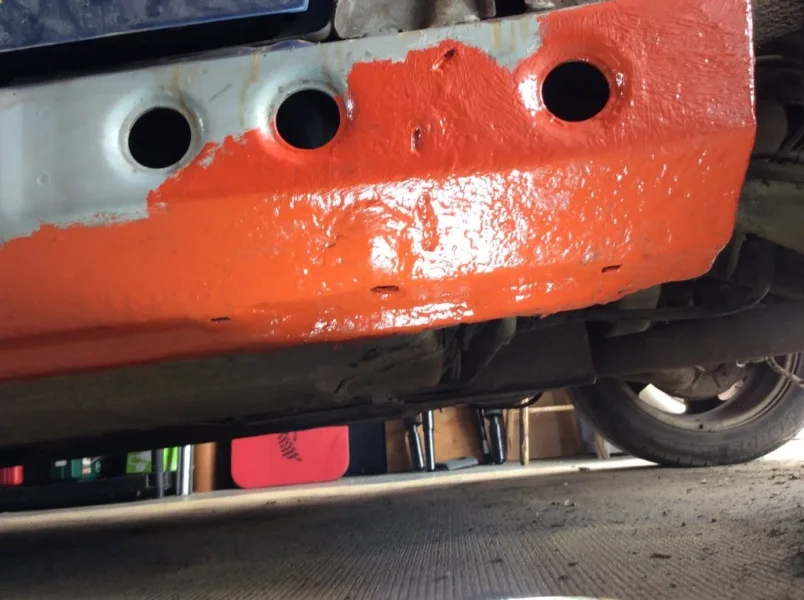

After a couple a days tidying the garden, and finding better storage for all the bits I have removed so far, I got back on with the task in hand... the sills.
So a second clean off with a thing that looked like a pan scourer on my angle grinder, gave both sills the FE-123 treatment. This goes on white which makes it easy to see whats been covered, unlike some of the clear versions.
I jacked up the front end just to give me a bit more wriggle room.
Just used a 1/2 inch brush

After about an hour of playing around with the stuff at the back, the sills were dry and all the rust had gone black.
So a quick overpaint with some red oxide, and then leave it for 24 hours.
Probably give them a coat of primer and then a top coat of something like a black stone chip.
Probably give them a coat of primer and then a top coat of something like a black stone chip.View attachment 176903

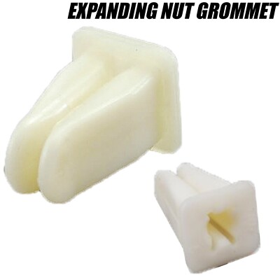

I did notice that there were some plastic clips still in some of the holes, so I went round and pulled them all out .....going to have to replace loads of them, so I might spnd the afternoon looking through RealOem to get all the part numbers.
