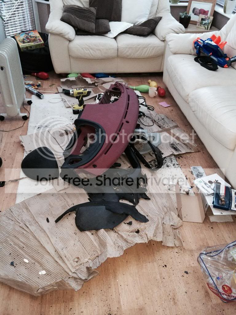

Next job was to tackle this, and to be honest it was one of the things that really put me off the car.
New screen from eBay (£80)
Pickles came to help, but in the end i needed my wife to offer a second pair of hands. it took about an hour. Its a bit of a pain to do but only as you have to try and do it from inside the car with the roll hoops in the way.
et voila
Defo worth doing at home

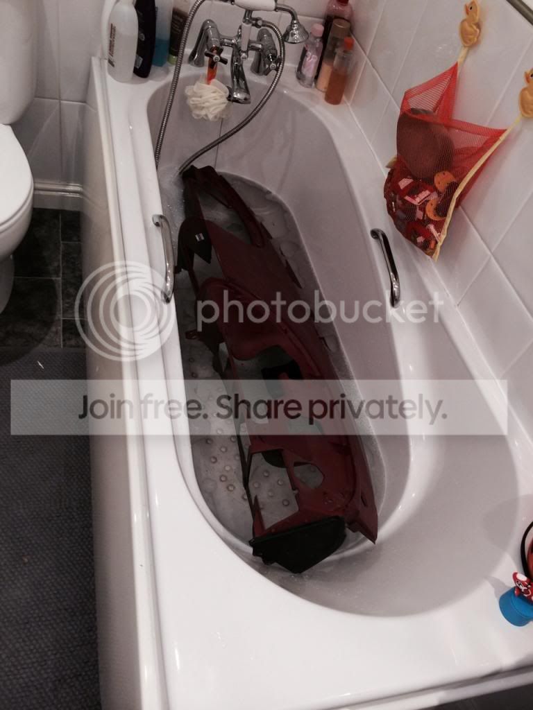

In parrallel to all of this i had removed all the boot carpet (dead easy) and taken it into the bath for a wash. Some bio washing powder and some hot water and it was all brand spankers.
