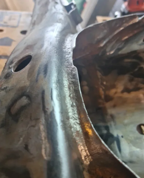

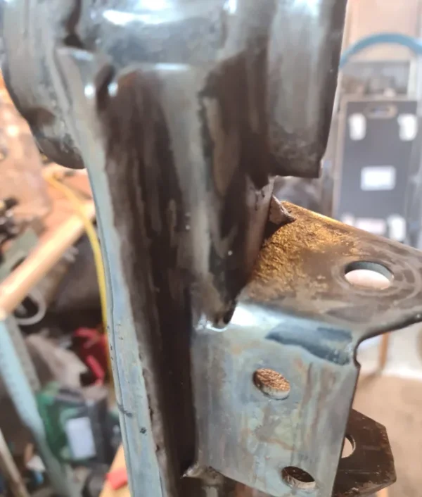

Then it was on to grinding off as much rust and brown patches as possible...paying attention to all the bracketry and welds...using a combination of angle grinder, Drill attachments and my new set of Dremel wire cups and wheels
inside of the sub frame bush holder thoroughly degreased..
Cleaning up all the bracketry and welds...

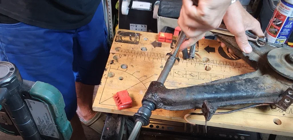

well after spending most of yesterday drinking (Me Birthday !) , there was no chance of me going into the garage !... so....it had to wait until Sunday.... so it was time to remove the Trailing Arm bushes.... I opted for the Threaded Bar technique... and must say, it worked a treat !!
Threaded bar with a washer and two locknuts one end, Box spanner and nut the other. keeping the bar from turnnig with one spanner and winding the box spanner into the bush the other
Rinse and repeat for the other side......
