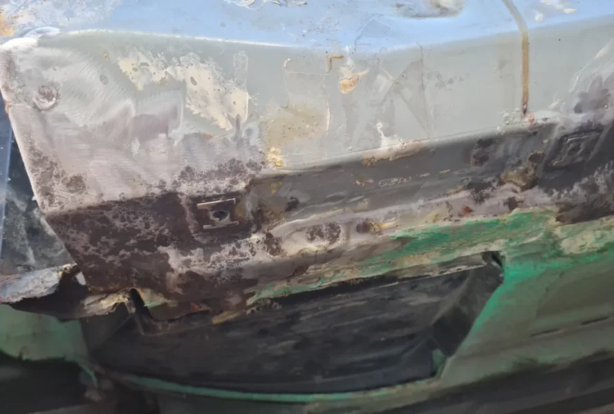

Took today off, and instead of enjoying the warm sunshine... I'm doing this !...… must say my Dad's old flexible drill attachment worked wonders getting into all the crevices of the springs
maybe a bit overkill but I treated them to a coating of POR15, which after 20 minutes, washed off and dried gently with a hot air gun. Later I'll give a couple of coats of Hammerite primer and a Hammerite top coat
Decided to have a change of scenery and peeled off the plastic and De-Ox Gel, that had I'd left on there for about 4 weeks ! :oops::whistle:
so took the polycarbide discs to it... and this is where I am now ..... all looking a hell of a lot better, and welding up those holes aside, almost ready for some epoxy I reckon.
Offside Front sill
Offside rear.....
Nearside front sill.... this is as much as I can do until I brave lifting the front of the car...
Nearside jacking point
Nearside rear sill

DrWong
May 8, 2017
125
3.0i
Good progress mate, keep it up!
If that's as far as you're going with the Deox and are now thinking of epoxy, I'd maybe consider the POR instead. Mainly cos there's still some dark rust pitting and epoxy tends to require bright clean steel as the substrate (at least that was the case with Lechlar, according to its data sheet).
POR on the other hand is designed to go on exactly the surface that you now have, i.e. on top of rust that isn't loose.

Deox gel tends to do its job within a few days. I reckon if you'd wire-brushed and reapplied the gel every few days for the last four weeks, you'd prob be nearly there now or thereabouts (sorry!)
It's the pitting that's the issue, cos if you put epoxy on top it's likely to rust through from inside to the surface. I honestly think POR is your best bet given where you are, because it's designed to go on top of and neutralise rust. Or try and find another epoxy, but I think most will similarly ask for clean steel 😔

Hmmm, just checked the data sheet ( Download.aspx (lechler.eu) ) and it doesn't actually state clean steel, just that the surface has been degreased and sanded.
However, I painted Lechlar over rust (remember the prestal cages I mentioned a few pages back) and the rust came back through within a year. Removed the cages, cleaned back to bright steel and epoxy'd and been fine since. From all the research I did before I sorted the sills, the general consensus was epoxy on top of rust is a no-no.

If you want a quicker result on the pitted rust I used a stronger acid from Rust.co.uk but as Dr Wong says you do need the steel clean I had to redo part of one of my corners as the epoxy lifted from a small rust flake so I stripped at all back on that corner just to be sure and all was fine. That was last summer and all still ok when I checked recently.

I’ve done sills, bits of wheel arch, front suspension bits (ARB and brackets) and used the same workflow on all - poly discs > Deox > epoxy. That’s pretty much my standard approach now.
Give the Deox another go. The key is persistence. I know how mind-numbing and tedious it is to keep messing with the gel every couple days, wire-brushing and then re-applying it, but you just have to grit your teeth and power through.

After getting to clean steel I would go over my surfaces with Phoskleen B which is an acid with phosphates that turn the bright steel grey and gives some protection you can read the gumf on the Rust.co.uk site. I did you zinc primer and then painted over with epoxy paint then added a layer of tiger seal as I have no compressor to use the 3M under seal which you can get in the appropriate green but in my case a rattle can to finished off.
