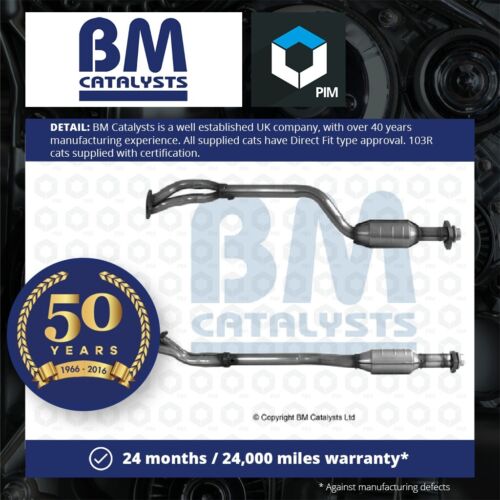

When you start looking at the CO2 emissions, I've just been through this on my 1.9.
Tried all sorts
Oil / filter change
Redex
New plugs
New coil pack
Cleaned the MAF
Ran hot
New thermostat (was faulty and keeping it choked)
New CCV valve
Cleaned DISA valve (check it's not gone)
New lamba in the exhaust
New standard cat
But what really made the difference was using a type approved cat. Wasn't legally required, but it sorted the emmisions. When buying look for one like this
Good luck with the wheels
I agree 100% with the type approved CAT. The next best thing to an OE
