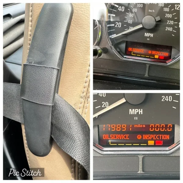

i was able to do a few other little jobs too - fitting the seat belt guide hack/fixes, replacing the bulb behind the odometer and a tail light bulb. I have also now noticed one of the number plate bulbs has blown, so adding that to the list. (How strange that the tail light and number plate bulbs weren't picked up in the MOT... 🤔)
Road trip tomorrow to pick up some 17" style 18s with plenty of tread left on the tyres, all for less than I would have spent to put new tyres on the 16" 'Star' style alloys 👍
I need to figure out how to reset the service indicator now. The OBD adapter I got clearly isn't the right one I need. My port doesn't look like the one in the videos about jumping pins 7 & 19. Another post in the tech forum coming up about that!
