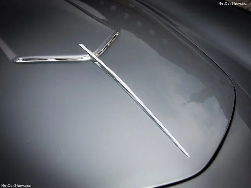

I posted the question after seeing the attached picture while doing my own research.

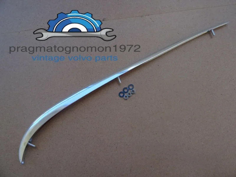

This might be a good staring point, from volvo 122 bonnet

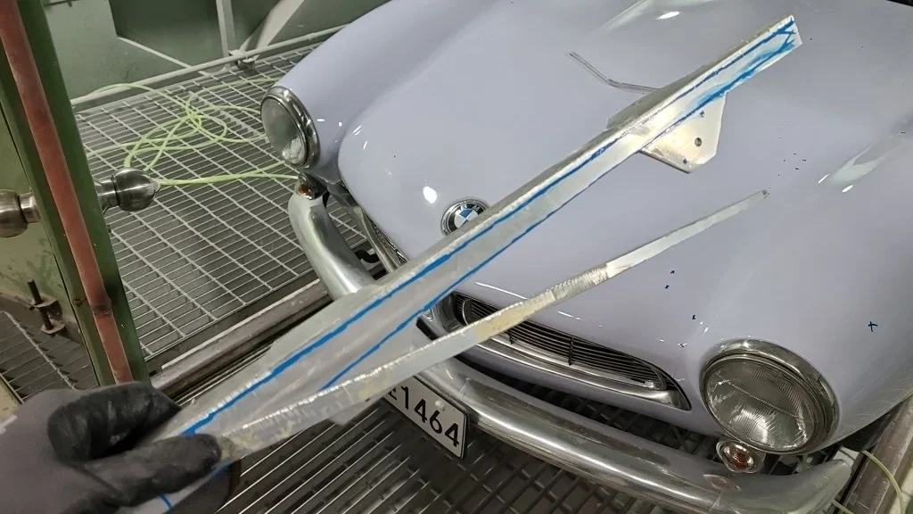

How about making it using alloy? I'm currently making it using a 2t angle. These are the leftover ingredients from making the side steps.
Oh. This looks like something. Looks just the right thickness.
Old front bumper.
Cardboard template and chop out a piece
Chop it about a bit and
Bit of grinding later
All that was done with the old angle grinder. Now to get out the hand files and do some finer shaping.
Still a bit more to do. Couple bumps in the bottom surface. Thinking about a thin grommet under it maybe. Not sure yet how to attach it so it doesn't come off and go bouncing down the motorway. Maybe small screws from underneath.

It looks thick enough to take an M4 (8mm A/F nut) or, at a push M5 (10mm A/F nut) thread, so I would use two, maybe three studs, with washers and nylocs. Clearance holes 0.5mm larger than the thread will allow for alignment.
I wouldn't use bolts, as the thread may strip inside the trim.

Yeah. Gonna put two M4 studs in it.
It polished up nice. Wondering if I should laquer it or maybe that'll look naff when the laquer gets chipped. The alu should stay nice if polished now and then. Shouldn't it?
