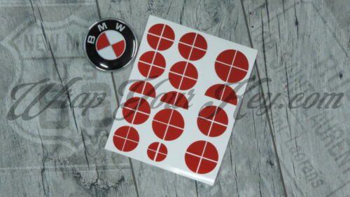

Then the Postie dropped the badge Decals through the letterbox, and as I was in waiting mode I decided to do this.
Just the boot lid badge left to do now.

Tomorrow I'll wash off the blusher.;)
Oh, got the boot badge done too.

You missed a bit! I can definitely still see some white, but I'm sure @AleNod has a spare rattle can from when he did his kettle 😜
Finished doing the badges today.
