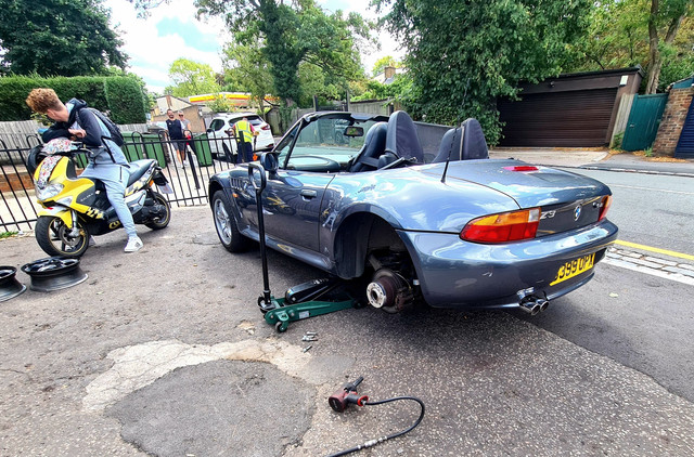

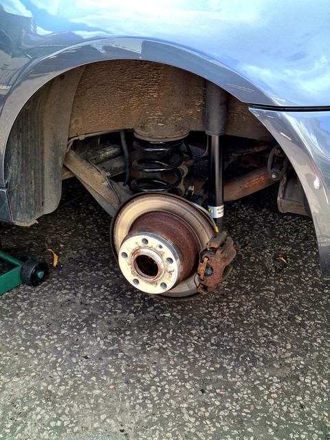

Zed went in for all the work, today. B4s with Eibach Pro -30mm springs, 10mm spring pads, new bushes incl ARB, braided clutch and brake hoses. Looking forward to picking her up and comparing the difference.
Well what can I say....

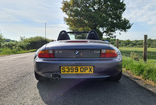

I think I’ve found the perfect setup for what I needed. The car not only looks 100% transformed with the slightly wider 10mm rear spacers, but with the B4s, 10mm spring pads and -30mm springs, also rides much tighter but critically without huge bangs and crashes on back roads or over speed bumps. Highly recommended setup.

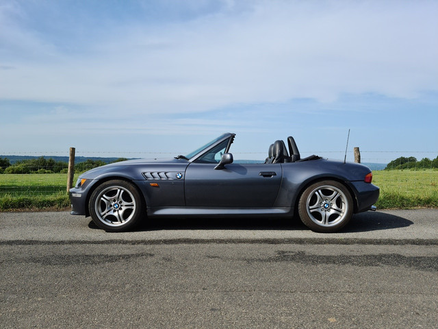

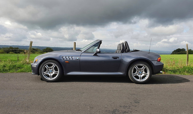

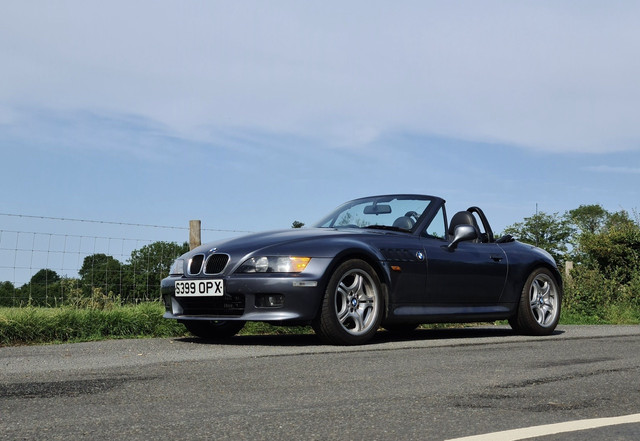

Before and after shots...
Before
After

Haha! Thanks Scooblitz. Honestly, the setup looks and feels perfect. I don’t think I’d want to go any lower and the new 10mm spring pads have helped ensure its more usable. The handling has also improved and feels more planted - but then I also replaced the ARB bushes with Powerflex, so that’s likely to have also helped.
All new braided clutch and brake hoses too, plus finally got around to sorting the seat bushes so no more shifting back and forth in my seat!
For the low cost though, 10mm spring pads could be a good option for you. I’m also guessing my new setup still has some way to settle a little too, so the end result may well be slightly lower still, meaning 10mm was def required.

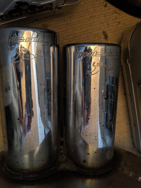

Which SS fits the 2.8? I actually have one but it was gas cut off another Zed although not sure what. Was thinking of a way to get onto my system somehow; likely with some major welding!
@inkey$ Would not be surprised if the back box was somewhat generic. Perhaps worth taking this along to a local custom exhaust place and get a full stainless system fabricated with this back box. The back box is usually the most expensive item. Perhaps this supersprint with a custom high flow sport-cat-back would be nice. Certainly on my list for 2021. Would guess it would be less than £250 to get this on and some custom bits around it.
Car is emerging as one of my favourites on the site. It's amazing how a little lower and 1cm of spacer makes a massive difference.
Looks pretty similar to mine - just needs a bit of pipe welding on to reach where it should (mine connects mid way under the car, a bit after the cat)

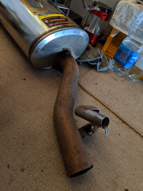

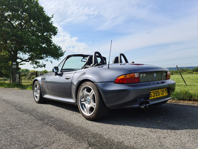

@Scooblitz @Dino D thanks for the advice and photo. I might speak to Zero Exhausts in Ashford. Used him on some custom stuff for my old Z4M coupe and he’s an artist. Here are a couple more pics of the box and connection points.

Update on the Supersprint cat-back pipe refurb and installation. After looking at reviews, I think I‘ve decided to go to a guy called Dean at Pipecraft in Basildon. Gets some pretty good feedback and when I explained what I wanted to do (add an end-pipe and bracket so it fits my midpipe), he said that sounded fine and I’m going to pop over for a chat in the next week or two.
It might sound awful, but at least I’ll be able to return to stock if I need to and have the option to use again in the future or sell on as a complete Supersprint cat-back system.

This Friday I’m heading over to Pipecraft in Basildon. After a quick trip over to see Dean last week, we looked at the Supersprint back box and he’s going to mate it to my stock setup at the first pipe bend. Easy to do, easy to return back to stock if needed and roughly an hour of labour.
Looking forward to hearing what sort of difference it makes to things like tick over and over run. Will update once I’ve had the work done.
Good plan and easy to pop on and off if you sleeve it.
Doubt you’ll want to change it back though!
It’s a well made muffler that is near stock on light throttle opening.
Give it some time to heat up and bed in, they sound very different when cold vs hot.
