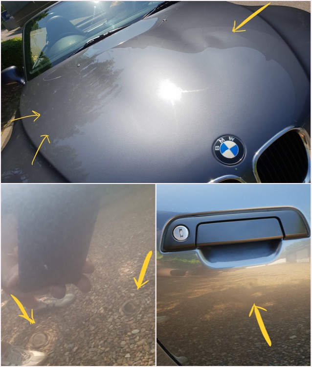

Project update: Booked her in for an Inspection 1 today. Also order a new throttle cable from Mark at Sopers in Lincoln and investigating costs on dent removal as I have five or six small dings on the doors and bonnet, plus a larger dent that’s tricky to see. - also on the bonnet (pics below). It’s such an odd dent I didn’t actually notice it when I bought the car; only when cleaning for the first time.

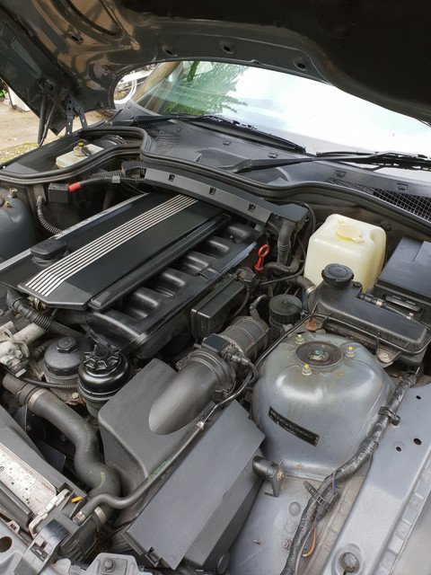

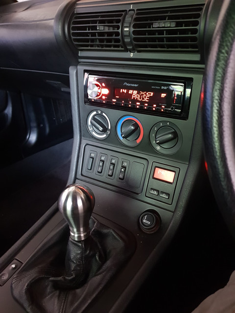

Today I’m getting the Alpine CD head unit replace with a mechless Pioneer MVH-580DAB which as the name suggests is DAB enabled. Also has Bluetooth, USB and hands free.
Once the Inspection is done it’s time to tackle the clutch, look at suspension options, refurb the new wheels, sort the seat bushes out and a whole host of other jobs that will keep me busy this summer!
New DAB and Bluetooth headunit in and lighting selection orange to match the rest of the interior lights.

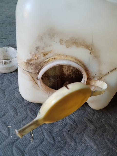

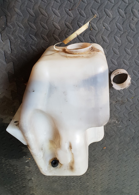

Was going to do the seat bushes today but it was just too ******* hot, so instead I took off the washer bottle and tackled 19 years of ingrained algae and scum.
All good with cleaning. Combination of Cillit Bang spray, baby wipes on wire and a 70 degree session in the dishwasher had the thing looking nearly new again.
Problem with reinserting the grommet now as the filter tip to it doesn’t seem to want to remain in place, but I’ll work that out I’m sure.

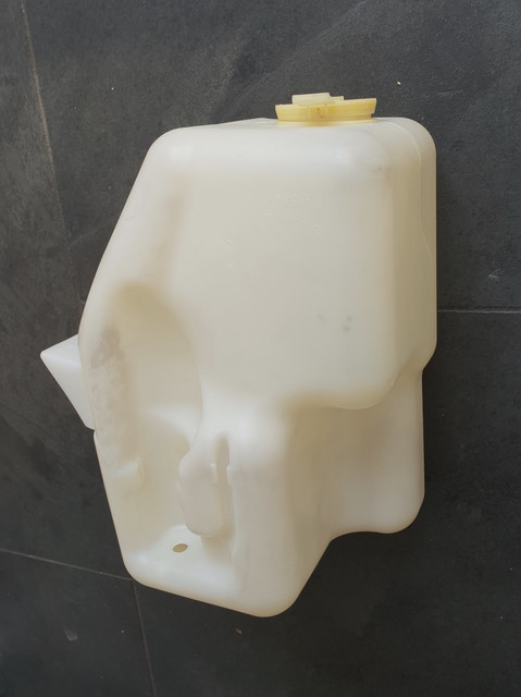

Today’s jobs included replacing the washer bottle, driving a few hours in the sunshine and washing the mesh wind deflector. Was pretty ingrained with dust and dirt...
Cleaned up washer bottle, standing out like a bit of a sore thumb now!

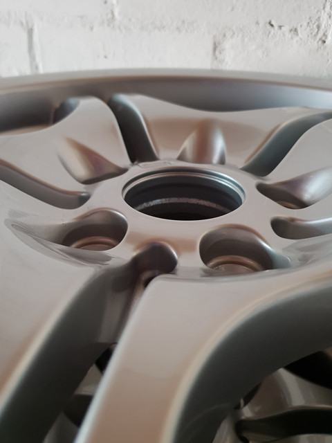

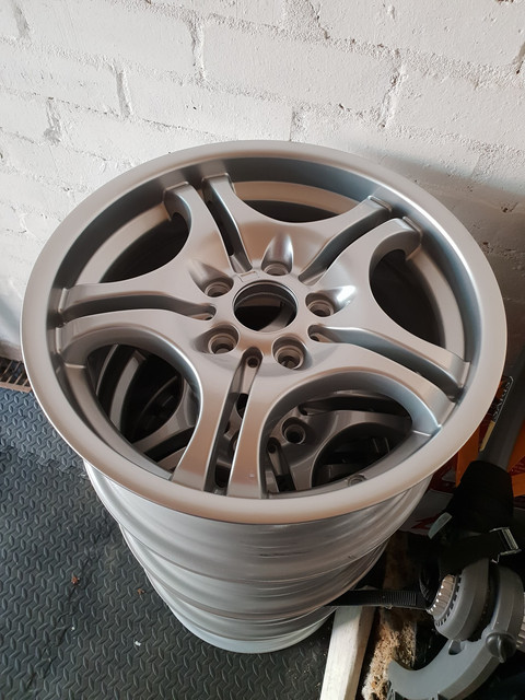

Still no nearer figuring out if I’m keeping or selling the Steel Grey (!), but in the meantime I’ve managed to get the 17” Style 68 wheels I picked up on eBay, refurbed.
The team over at A1 Alloys in Bromley have done a great job for me, stripping, fixing, powder coating and lacqering them back to their OEM silver former glory.
If I do end up keeping the car, then these will be treated to a set of box fresh Kuhmo Ecsta P71’s and fitted to the Zed asap.

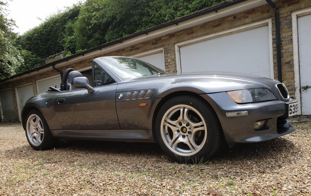

Fitted the refurbished Style 68’s today, complete with a full new set of Kuhmo Ecsta P71’s.
In my humble opinion its transformed the look of the car. New centre badges incoming but even without, its safe to say i’m very happy ;)
