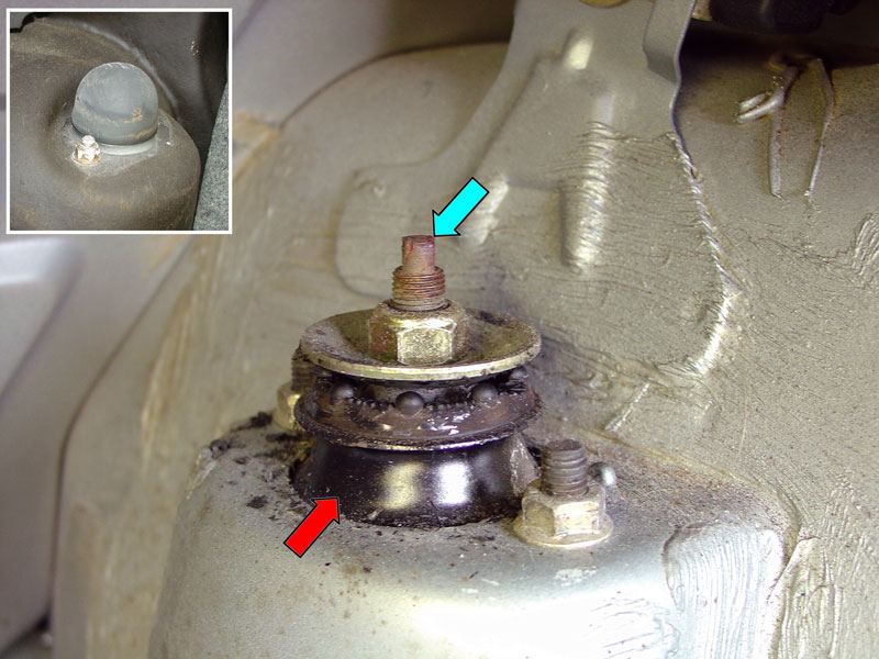

I think they are part of the shock Gary, essentially the plates are a large cupped washer the same diameter as the metal part of the shock mount.
Pic pinched from the internet to help. Different car but you get the idea.
Edit: Are you sure they have not been mounted on the underside of the shock?
