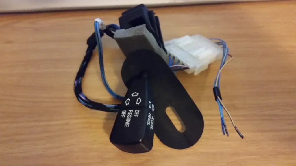

Step Forwards - Cruise Control fitted. Process exactly as per @Brian H's article, so thank you for that sir!
Doesn't seem to be any visual indicator on the instrument panel that it's on, but works fine on a test drive. Looking at the picture I better head back out and tidy that loose bit of rubber I didn't tuck back under :whistle:
Component parts:
Switch & stalk:
Interface:
