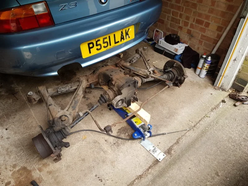

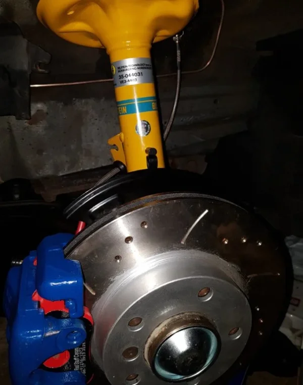

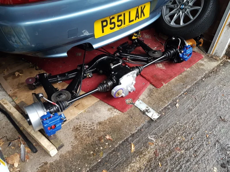

About time I updated this thread.
Summer 2018:
  • Polybushed Rear Beam, Trailing Arms & Differential
  • All rear brake pipes renewed using kunifer brake pipe
  • All shocks and springs replaced with Bilstein B12 kit (includes Eibach 30mm lowering springs)
  • Rear beam, trailing arm and diff - rust removed and painted in POR 15
  • All brake pads upgraded to EBC Red Stuff
  • Front Calipers upgraded to use calipers and vented discs from 2.8
  • All 4 calipers painted
  • Fitted Stainless Steel Brake Hose to replace old rubber brake hose
Only issue now is that my aftermarket exhaust that I had fitted 2 years ago does bottom out occasionally over speed bumps!
