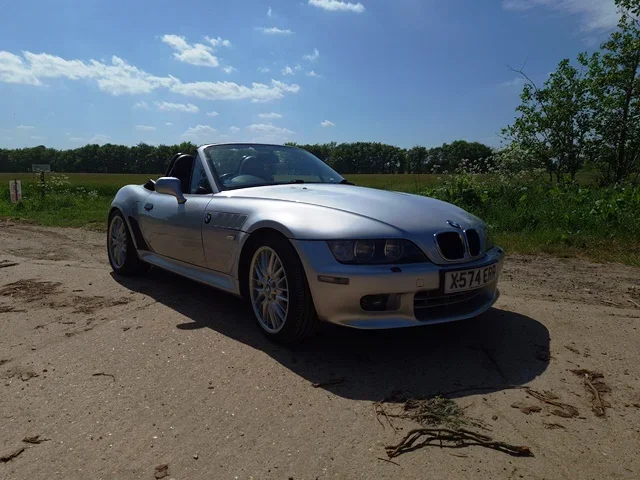

With the weather being lovely yesterday we took the car out for its first real drive since owning it and straight piping the back box but leaving some of the mesh exposed has produced a great sound with absolutely no drone. Very happy with it. Noticed a sticky calliper on the near side and stuck the stone chip guards on just to hide some of the bad paint. The guy who originally sprayed it has refused to answer any calls/emails despite now trading again so I am in the process of putting a small claims court case against him for the following
New roof as it looks like he has spilt thinners on it and it has gone white
Totally respray the rear end and the side skirts he has messed up
Replace the wheel arch liners he has sprayed silver
Two new rear tyres that have over spray on
Refurb the rear 2 wheels (I had only just done them as well as fitting new tyres) as they are caked in overspray
Repaint the rear callipers that are covered in overspray
Replace the door trims and roadster trims that are also covered in over spray.
The rest of the car I managed to claybar and polish the overspray off.
But from a distance she looks nice through squinted eyes! 😂

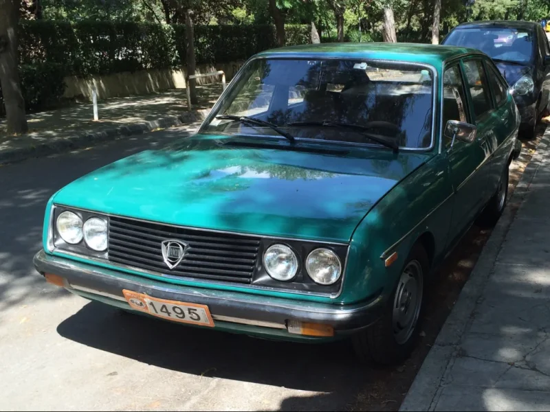

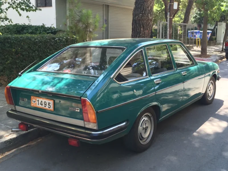

was in a similar situation some years ago.
a friend recommended a paint shop and by what I have seen his car was done nicely (but not perfect).
visited and was quoted 1.200€ for a full exterior respray that (for Greece) is on the low to medium money for a single stage.
they kept the car for five days and called me on a Friday night to tell me that I had to rish to get the car as the owners mother passed away and he will be leaving the next day for Albania so the shop would be closed for quite sometime.
realised that the paint job was horrible immediately and asked for a redo or money back.
he promised to fix it first thing when he returned, and as an act of kindness due to the circumstances I left.
outcome: the shop closed for good, he never came back and the car was a real mess.
did not want to spend more money on the car, so decided to try and fix it myself.
marked all bad spots, sanded them, then sanded the whole car with a finer grit and bought a rotary polisher. Started with 3M hard paste, then 3M fine cut, then 3M polish and finally with some extra fine paste.
took me a lot of courage and three weeks to finish, but finally the car was better than acceptable. (Surely way better from what it was before). Still much orange peel and quite dull in low light, but a thousand times better than before (with tiger stripe oversprays, paint runs and sand feel to the touch).
sold it with a little profit to a young man who had no idea of what a good paint job is and was very pleased that I reduced my asking price by 300€ due to old tyres and a broken cassette player.
imho, you are not satisfied so why not try to correct it yourself.

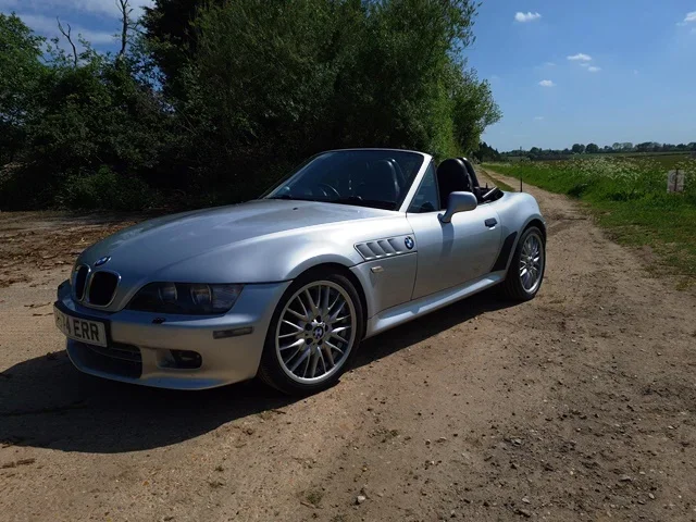

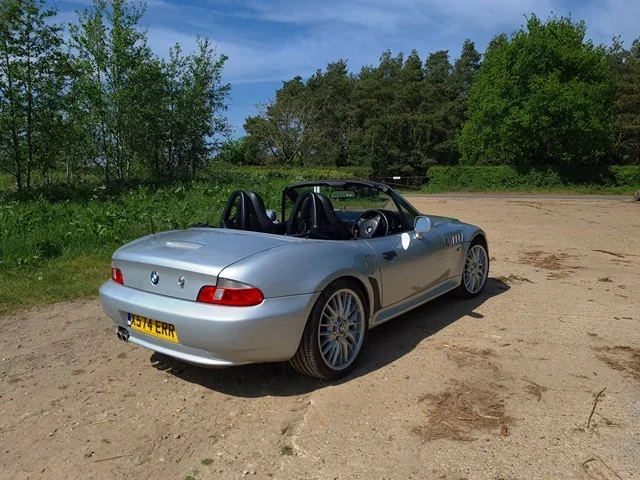

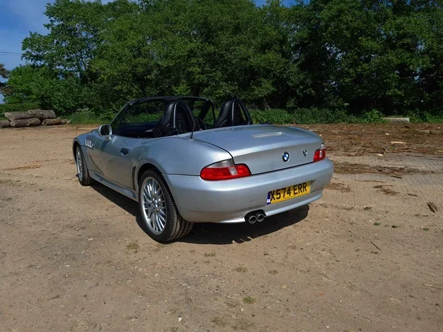

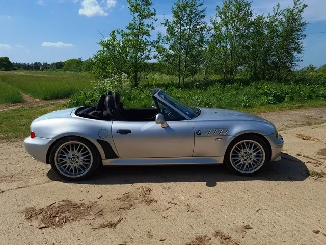

If you look through this post you will see how the car was returned and how it stands now and I have spent a fair while on it using a rotary polisher and that was just to get the overspray off the ENTIRE car before you could see how poor the paint was. The only option now is to wet & dry it back, clearcoat it and try to tidy it up. Your story sounds very much like mine!
