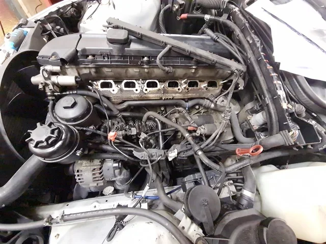

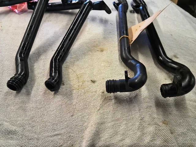

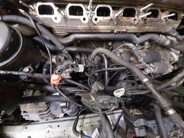

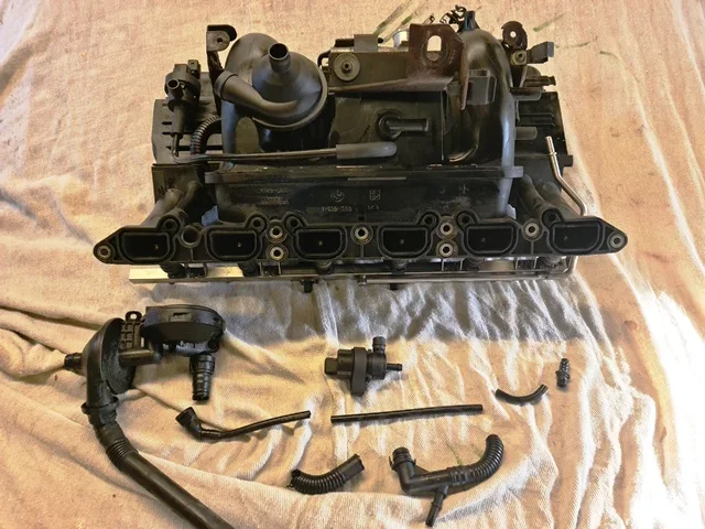

So after getting several codes decided to bite the bullet and ordered, Crank case vent kit with all new pipes, purge valve, the 2 hard water pipes, rad sensor, block sensor, new gaskets, vacuum hoses
2 hrs later the manifold is off ready for the new bits to be fitted and found the manifold was only held on with 4 nuts (Should be 9) and one of the crank case breather pipes wrapped in insulation tape (why you would strip it apart to do that seems stupid) hence why the bottom was covered in oil.
So now its in bits decided to take the brackets off and spray them as they were rusty and when the final bits arrive time to rebuild!

I think getting the manifold on and off is one of the worst jobs with these engines. Keeping track and not loosing the little nuts is not an easy task but it doesn't explain why five of them were missing.

TBH I did not think it was too bad but I would recommend loosening off the manifold and wiggling it up and seeing what else is attached to it using a mirror. The procedure I had was for a left hand 4 cylinder which was as much use as a chocolate teapot! I gave up after trying to use that within the first 20mins. Its a pretty straightforward procedure. Putting it back I think will be harder!

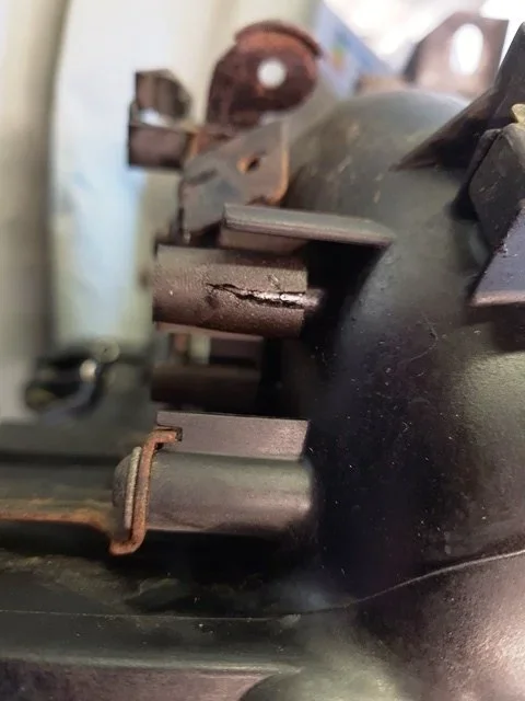

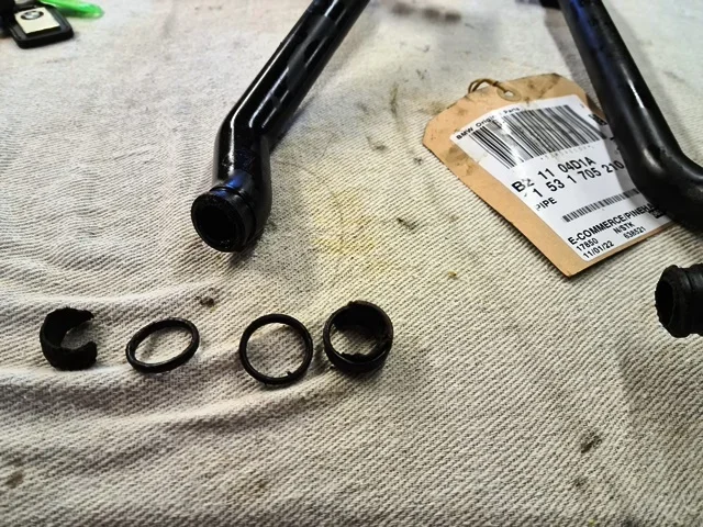

The crank case vent pipes crumbled away in my hands and found a plug split on the manifold but the major PITA today was once I had removed the hard water pipes found that the ends had actually broken off in the block which took me ages to dig out. :bashhead:

Bang on there man, a selection of photos showing all the common age related wearing items. Fingers crossed she runs like a dream now.
P.S change the manifold to block seals.
