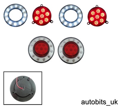

Have you seen the rear ‘ring’ led lights? Not the Ring company. Kind of like an led version of the old round Ferrari lights.
Those can be linked in various ways.
Outer ring marker, inner brake.
Outer marker/brake, inner indicator, fog, reverse, or reflector.
Ill try and post links when I get home, I’m on a bus, trying to type whilst bumping about is hilarious.
Those sound good. I like the idea of a bit of symmetry between back and front with the rings.

Rear lights, I can’t find the company I bought mine from. They ended up on a trailer as they just didn’t look right on the back of my Pontiac.
Similar to these, but 12v:
Mine were clear until illuminated. Copies of the Hella units, which may be why I now can’t find them, but 1/4 of the cost. I think the guy who bought the trailer was more taken with the lights than the trailer.
Can be flush or surface mounted.
I was sure I had a spare ring and Center, but I can’t find them to see if there’s a name or part no on the back.

I have a spare center console I bought for exactly that if it’s any help Tom.
