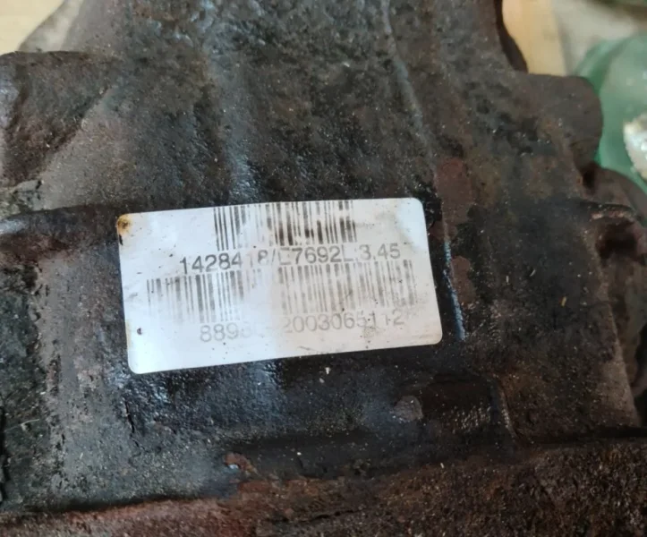

took the bin bags off the rust and was quite impressed
@DrWong ..doing job nicely !.. I've just setup a Screwfix account to ordered a cheapy angle grinder and some cup wheels... I'll add another layer later on...

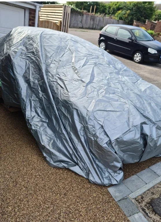

and now I'm officially.... That One Neighbour
