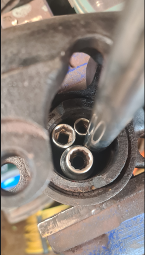

I set myself the mission today of finally removing the caliper piston.... I'd scoured YouTube and found one similar to jamming Allen wrenches in, (
which I tried but snapped the top off the piston)  but this one was by using sockets, an extension bar and a ratchet.
If you're sat comfortably..... I'll begin.....
you need to faff around getting the right combination. Mine was a 1/2" extension and a few sockets... put the sockets in first, then try and jam the extension bar in the gap. It needs to be really snug so that you can't spin it. Even a couple of love taps might help to really jam it in.
Make sure your caliper is in a vice, you can't really hold it by hand, then attach your ratchet, and you're good to go ..
now it'll take a firm grip but, slowly start turning the ratchet and the piston will start to turn as well. spray some WD40 in the gaps of the piston wall and the turning will start to become easier...
Then, whilst you're still turning gently start to lift as well, not too much or you'll pull the bar out. Notice it's more exposed now.
keep going and it'll eventually fall out....

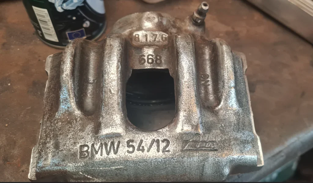

et voila !!!... this one will get binned due to the broken top.
Then it's a case of cleaning up the caliper ready for paint, and the Bigg Red rebuild kit
