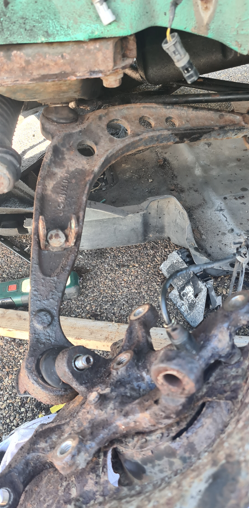

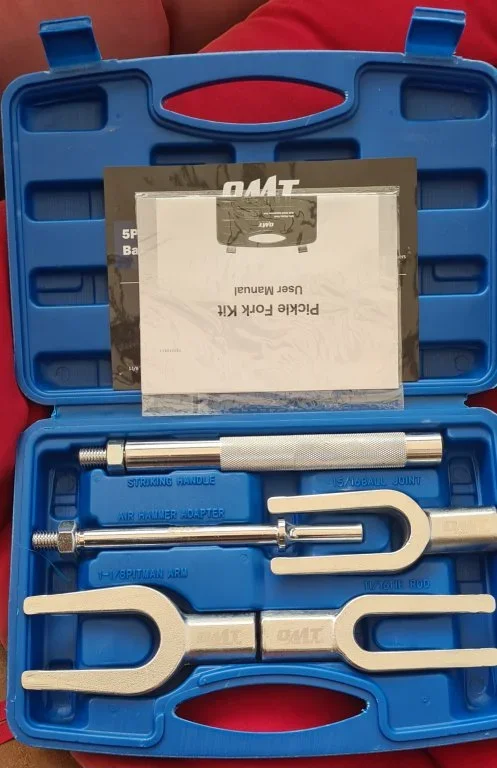

Then I attacked that lower control arm with the pickle fork and
OH MY GAAAAAAAAAD.... both came off in about 10 minutes !! ..used it as well to separate the lower ball joint from the knuckle... so as
@Althulas suggested, these are DEFINITELY the way to go if you're not planning on putting those ball joints back on.

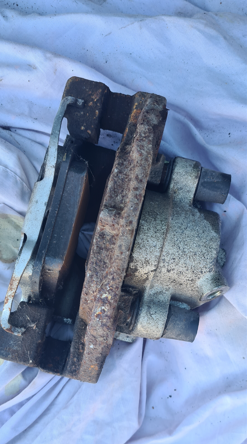

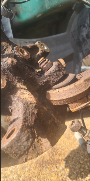

so for posterity when I look back, this is the state of the hubs...
and i had a little chuckle to myself when I saw the brake pad wear sensor was tucked into the clip
While I'm here" I thought.. I'll get the bearings out.....
knocked the tabs back .........
DUG OUT THE NUGGAAA !!!!....
The nut didn't round off on me like it did with the driveshaft nut a couple of years ago, so I think I've finally overcome my fear of Impact Wrenches.
used the old trick of dropping an extension bar down the hole...

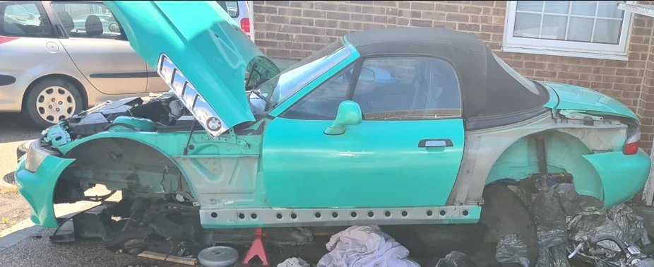

so that should be the last of the big parts off..... definitely onto the front end rebuild !!!
