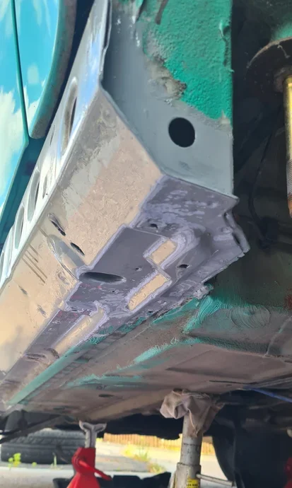

well today was back on the sills.....focussing on the nearside this time, which although crusty, doesn't have any holes that aren't designed to be there !!
standard fair... cupped knotted wheel on the angle grinder, and the carbide "sponge" type wheels, my new belt file worked a treat for tight corners and when either of those couldn't reach, I used the sanding wheels on the Dremel. That red is the pink bedsheet I have under the car ! =))
The Dremel is ideal for getting right into the jack pad holes
Rear done as much as I can
Then it was a liberal coat of POR15 Metal Prep. You have to keep it wet for 20 minutes, then wash off, then dry thoroughly for which I used a heat gun.
Then it was a good coating of POR15 Direct To Metal on the front and rear of the sill
and yes I did get rid of that drip bottom left... :whistle::whistle:... this will dry shiny and rock hard. After that you can key it with a scotch pad and then apply Epoxy Primer and top coat.

thanks mate, I've had mixed experiences with POR15. I had to take it off the offside sill as surface rust came back. My only theory is that I didn't stir it enough, as I remember it being really watery. This time I made sure it was thoroughly stirred and all one uniform colour. It did feel thicker this time and went on much smoother. Hopefully that'll do the trick

Good to see that you're not trying to grind out the rust pitted areas. I see too mamy people.going at it with an angle grinder till it's super smooth where it looks good but hardly any thickness left.
You're doing a good job. Better than I would. I'm too lazy. I just brush off the loose rust and treat with oily stuff. 🤷‍♂️

thanks mate...yeah this is as far as I'm going with the rust treatment. Then it's epoxy primer and paint. Need to get the car off the jacks soon as come next month it's been on jacks for a (gulp) year !

Groundhog Day..... as yesterday's use of POR15 went far better than my previous experience, I decided to go back to the offside, grind it all off and start again. Pretty confident there's now no rust in my inner sills !!..

I'm going to keep a close eye on the POR15 given it's dubious reputation... so a week later I took some more shots to see if there is a hint of peeling or degradation and not a peep.... I know you can't judge on a week but the car is sat outside with only a tarpaulin for company most days, and I literally face Portsmouth Harbour for some nice salty air.
next step (if you follow Redish Motorsport) is the rough up the surface, use epoxy primer (I've got MIPA two part epoxy primer), then stone chip paint; then top coat...
