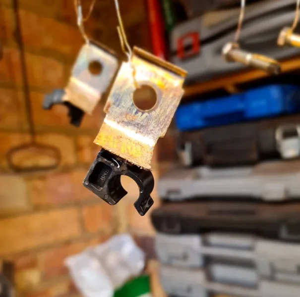

Then it was onto plating.. decided to tackle the handbrake cable support bracket and the rear Caliper bolts....the bracket took ages to get to bare metal.. ended up using the Milling bits in my Dremel set
Caliper bolts drying after being zinced
handbrake cable support brackets after being zinced... not great due to all the scoring from the Dremel

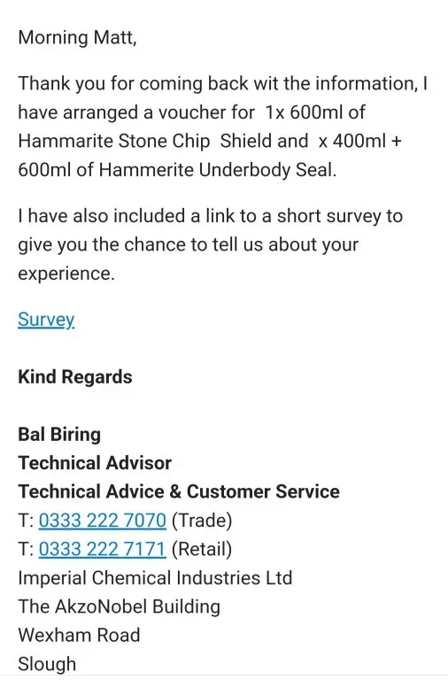

well..... some days you have progress and some days you have setbacks...... tidying up the garage for the umpteenth time and I knocked the rear spring and chipped the Hammerite and could literally chip it off with my finger nail.....I can only assume it's because I didn't rough up the Hammerite Primer before the topcoat..... this now implies that everything I've painted black... (pretty much everything) will have to come off and be redone... b***er.
Needless to say, I've now written to Hammerite.... I'll let you know the outcome

It has been a while since I have used Hammerite but as far as I can remember, you do not need to use primer or undercoat, just make sure that item that you are going to paint is clean.
You do need undercoat with Hammerite, but, it has to be their own and left to dry for a specific length of time between coats otherwise this happens.

Thanks both.....I'm really annoyed with myself...I did use Hammerite Red Oxide Primer and left it a good week before painting the top coats... I'll look back at my posts to confirm the time... but at the time I recall thinking to myself "this surface is really smooth"... and the black just glided on and looked epic.... think I might try is rather than going back to bare metal …..again... just really rough up the surface and try again.....

So I wrote to Hammerite, and I must say, very impressed with their Technical team. Upshot is, it was mainly my fault. They politely advised that the Hammerite paints I described i.e. Hammerite Red Oxide and Hammerite Smooth Black are not designed for cars !.. They're designed for corrosion resistance of metal but not for impacts like stone chips etc. Apparently what I SHOULD be using is Hammerite Underbody Seal (guess the clue is in the name) or/and Hammerite Stonechip Shield Aerosol. All is not lost I feel. I might be able to get away with roughing up the under side of the subframe and Trailing Arms and giving them a thick coat of Underbody Seal
I think he took pity on my idiocy and is sending me a small can as a "goodwill gesture" =)) =))

That’s a proper company !
indeed...they could have easily said... you used the wrong stuff, and I did confess to Hammerite that I'd gone back and read the tins and nowhere did it state "impact resistant".. being cordial sometimes works, but I know now.... not all Hammerites are the same !!... I'll let you know how the Underbody seal and spray works...
