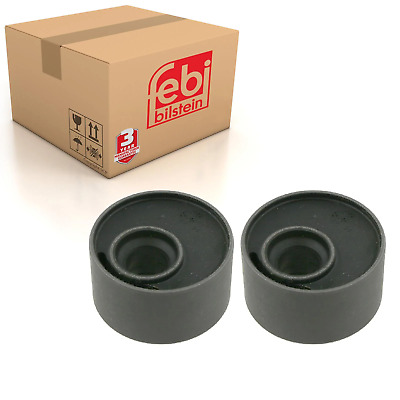

IainP
Feb 20, 2019
119
1.9
I've got 19" Konig Crosshair wheels on mine, so tramlining is an issue as the tyres are 235/35Z/R19 which came with the car. However refreshing the whole suspension should make the ride a hell of a lot better
Running those, make sure you fit the solid M3 style lollipop bushes Matt. The standard ones allow lots of deflection, especially when worn.
I wish I’d fitted those when I did my front end. Took previous owners’ poly lollipop bushes off and replaced with BMW OEM. Ride became more comfortable but steering less incisive. Wish I’d put them M3 ones in now, as they seem a perfect middle ground.

luckily I've only bought track rod ends for the front so far as mine are rustier than Titanic's bow. After I took the undertray off for Malc's fuel lines, I noticed the cross brace was a bit rusty in places, so I need to get that off, grind down and repaint. Are the M3 ones you're talking about with centre bolt hole as I've seen some where the bolt hole is offset

Go with the offset bolt hole, adds a little caster, I’ve fitted several sets now, there’s really no downsides. Other than making sure you fit them the right way round😆 Slide into the arms easier too, bit of silicone grease and they wind right on.
These are the last two sets I’ve fitted, different cars, not that they wore out.
I believe the first e36 M3s had eccentric lollipops, which then changed to concentric ones sometime in 1995. I'd personally get the concentric ones, but I'm sure the eccentric ones IainP suggests will be fine cos it's all designed for the e36 front end (which is essentially what Z3's have). I think the Z3m has the M3 lollipops as standard.
