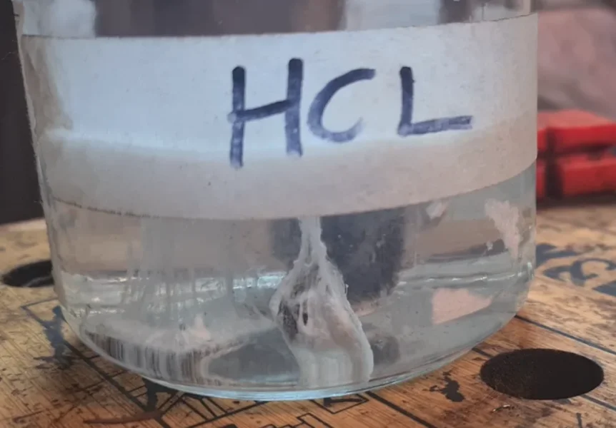

Hydrochloric Acid (HCL) which is 36% concentration, this is to strip old coatings and contamination,
De-Ionised water, acts as a neutraliser between the stages... the Zinc solution is in the bigger tub and then the passivate is to harden the zinc layer.
caliper bolt was cleaned to within an inch of it's life
It was then put into the acid until the fizzing stopped...

And that's where the success ended.... within 15 minutes, the parts had started to flash rust....I'd clearly gotten something very wrong...
There are two schools of thought.... one is.... after the HCL bath, you're supposed dry the part completely to stop the acid stripping process, the other school of thought is, you submerge in de-ionised water straight after the acid to stop the acid process.... I went the straight into de-ionised water to halt the acid... which clearly hasn't worked.....
