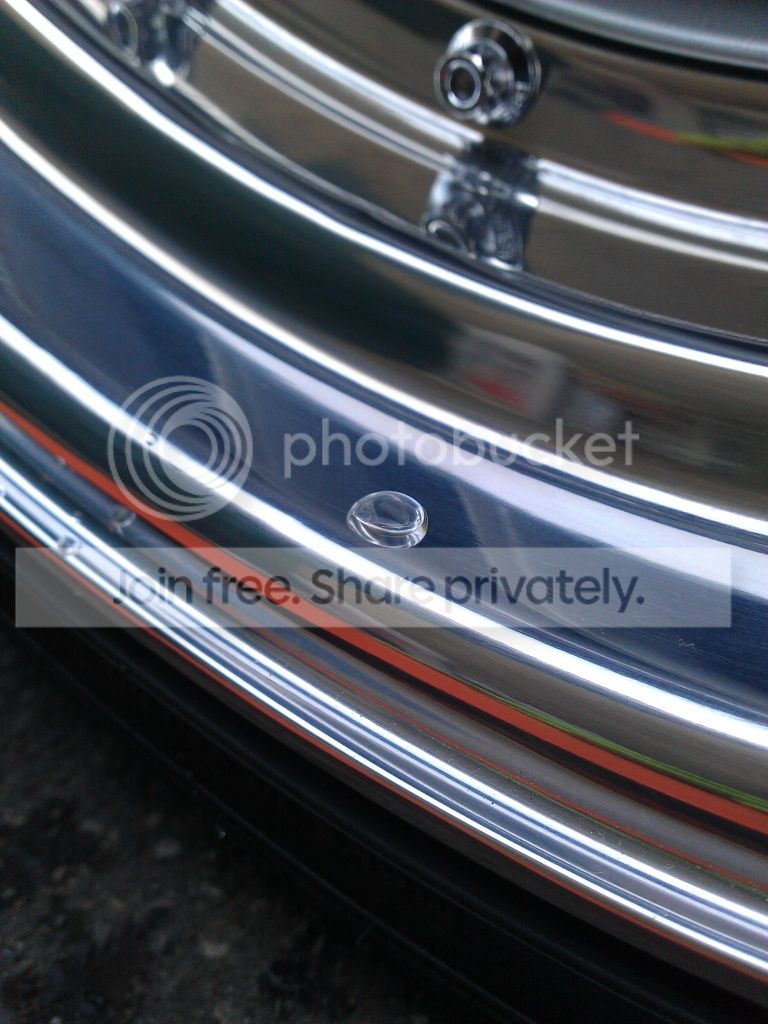

Ok so my wheels are looking pretty good after the refurb :cool:. I want to keep it this way so i'm planning on trying out a few different products and (for anyone interested) I will post results.
Wheel finish
Split rims - Outers are bare aluminium (no clearcoat), inners painted with aircraft grade primer/paint/clearcoat (very similar to a manufacturer's paint finish)

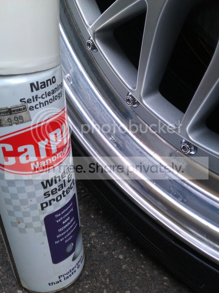

Products testing:
Car plan - Nano technology wheel seal and protect
Read about it here:
http://www.carplan.co.uk/index.cfm?category=68
Application
Very easy to apply, once the wheel is clean and dry spray on from 20cm~ away, cover entire surface. Leave to dry for 10-15mins and wipe off excess. You do get streaking so its essential to go around afterwards with a buffer.
Photo whilst its drying

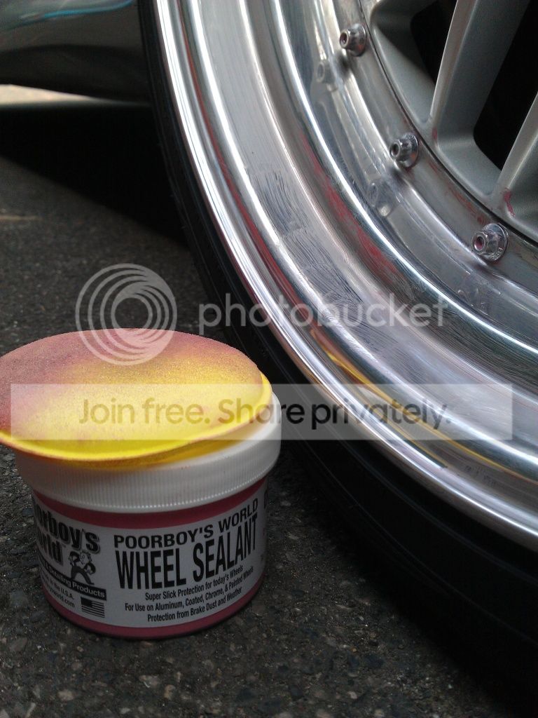

Poorboys wheel sealant
Read about it here:
http://www.poorboysworld.co.uk/cgi-bin/ ... db_epid=13
Application
A gel like consistency which dries similar to wax. Coat wheel and allow to dry to a haze, buff off. On normal wheels I would expect it to take about 15-20mins per wheel, it does take a bit of elbow grease to remove. For me it took 2 hours to complete one wheel because it got into all the little cracks of the bolt heads etc.. Not ideal for split rims!!
Photo whilst drying
After cleaning both wheels up its safe to say the poorboys wheel sealant beads better.
My plan is to update the thread with how long the product lasts and how easy it is to remove brake dust..

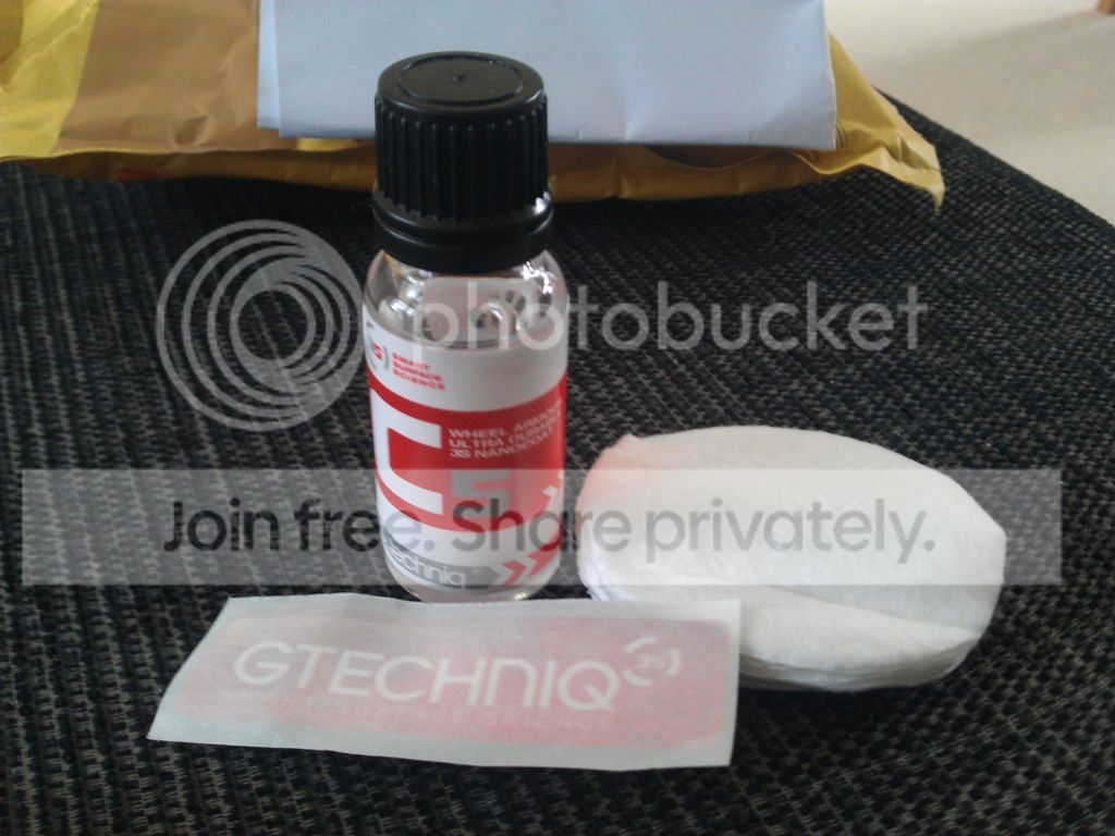

My final choice is:
Gtechniq's C5 wheel armour
Read about it here:
http://gtechniq.com/shop/3s-for-cars/ex ... el-armour/
Its by far the most expensive product but hopefully worthwhile! , this 15ml pot is around £25!
Apparently it forms a chemical bond with the surface and a single application lasts up to one year! :D
a video of it beading 9 months on:
http://www.youtube.com/watch?v=wD_sbYTuN9w
Application
Instructions can be found here:
http://gtechniq.com/shop/3s-for-cars/ex ... ctions.pdf
They advise protective gloves :shock:

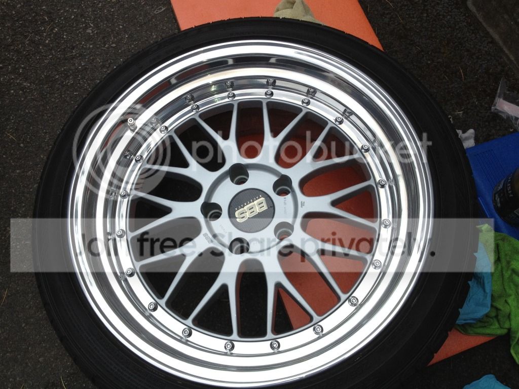

Ok wheels came off today and I went through applying the gtechniq.

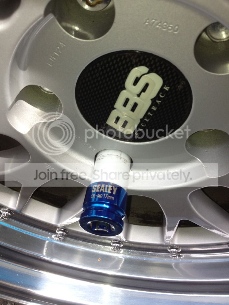

First off a top tip for anyone who likes to take pride in their wheels. Buy this:
Costs less than a tenner and saves the wheel from any scratches when removing/fitting.

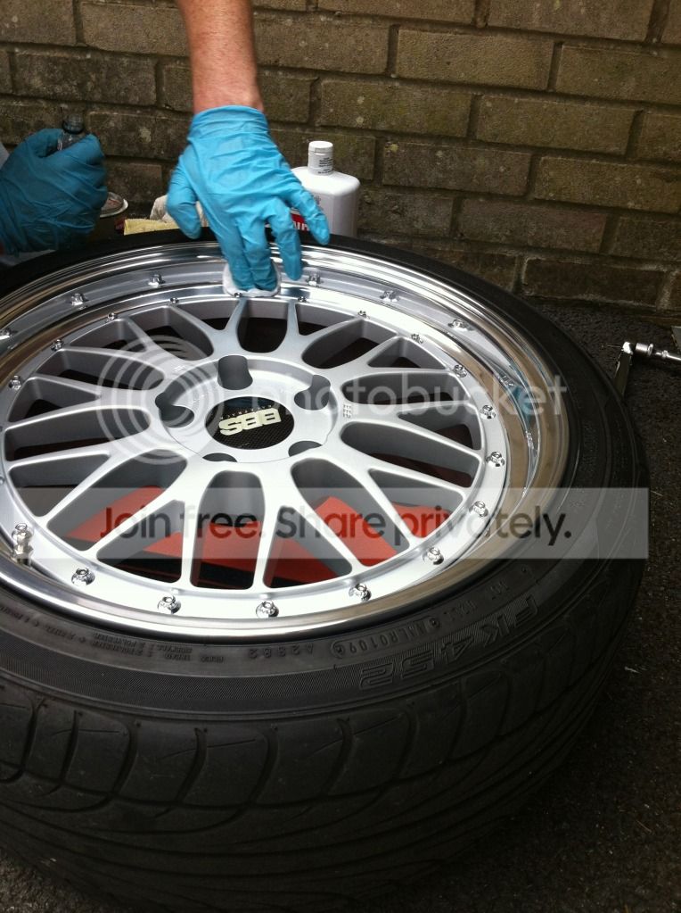

First off I cleaned the wheels and polished the outer lips with autosol - Ready for the sealant!:

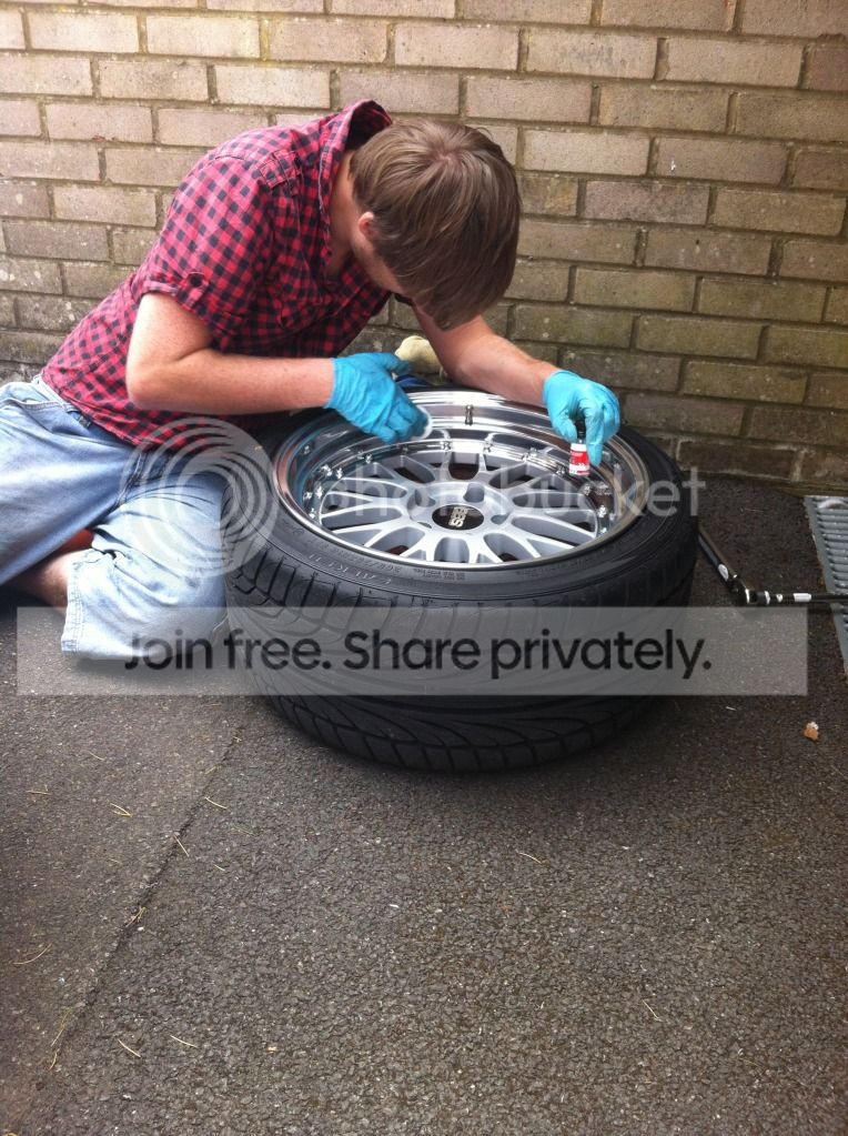

Then came the application, it is supplied with cotton pads so all you do is dip on the gtechniq and wipe around the surface. Make sure to wipe off any residue and get into all the cracks brake dust likes to settle.
Keep out of sunlight and avoid touching the surface whilst drying as it tends to haze up if aggitated.
application per wheel probably took 15-20 mins and was very easy.
Will update with longevity

Just remembered i'd missed off the gtechniq so i've updated the post above, I'd consider this over the poorboys daz, it is far easier to apply and lasts up to 2 years (rather than 4-6 weeks). The poorboys leaves a pink residue and seaps into all the cracks then dries - took me about 2 hours just to apply to one wheel!
