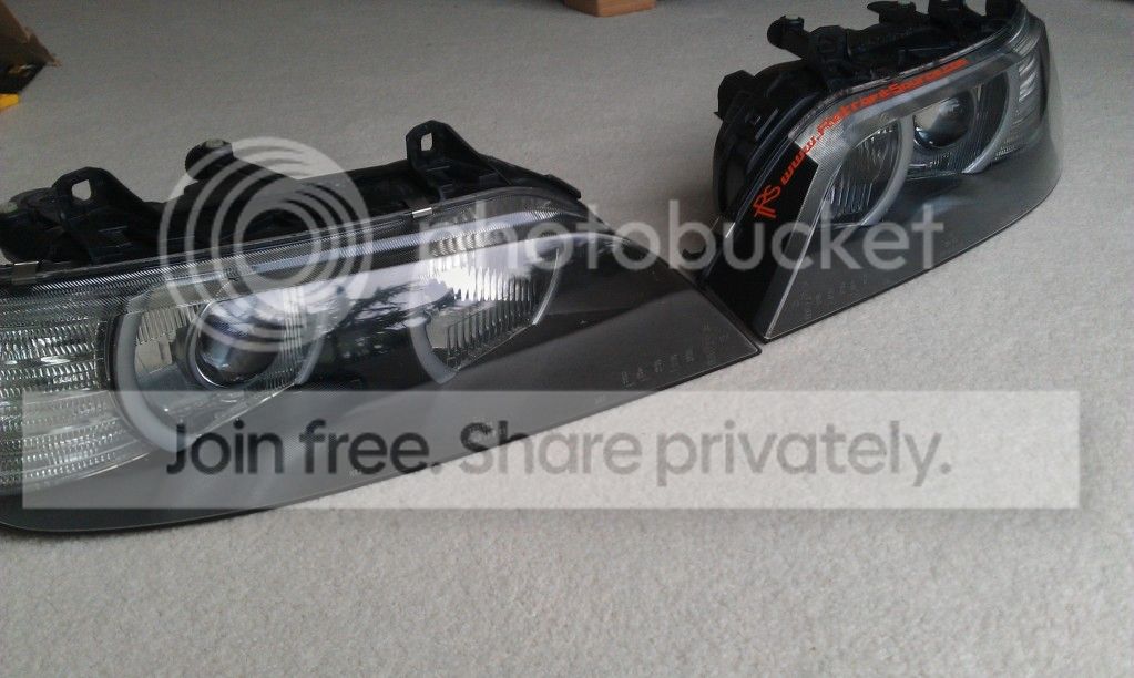

Re: Shantybeater's S54 - BMWCar Mag+Xenon Retrofit finished!
did the angel eyes go in?
Unfortunately not. The outer rings matched up perfectly but the inners didn't line up with the chrome rings at all. I tried to rear mount them which was even more of a no go. Shame but my OCD wouldn't be happy with them misplaced and visible

That's a shame. I was wondering how they would sit with the chrome so that answered that question and I would be the same, has to be right :)
Agreed, i'll keep my eyes peeled for a set which fits properly!

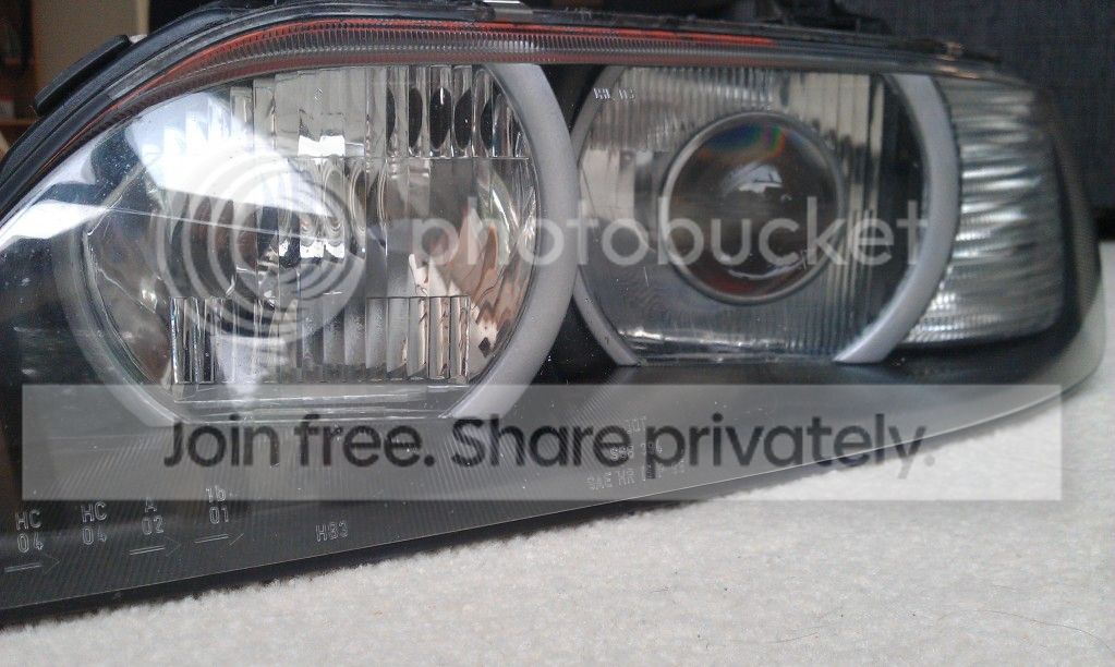

Another headlight update, hopefully the last (i'm sure i'm boring everyone now! haha)
I tried the chrome vinyl which didn't work on the rings so I masked and sprayed with titanium silver paint, the finish is much better. I used the chrome vinyl behind the lens instead to hide the projector which I think works very well. Will be keeping an eye on things since i'm not sure how hot it gets in there or how heat resistant the vinyl is!!

not boring at all! It's interesting to see the stages and the only downside i can see is me having to spend more money :D
Mine will have to wait, too much driving to do and not enough time to spend modding in the summer now :D
It looks absolutely great, truly OEM. Whether the vinyl will stand the test of time I'm not so sure. It must get hot, i know a lad who has a sign writing firm I'll ask him if there are different grades etc or a preferred brand. They must come across occasions that heat is an issue, I'll ask and let you know.
Is it silver or chrome that you're after?

Good job on the lights shanty look very OEM and a great detailed description :-bd

('_')Z3 - Please do, i'm after chrome or mirrored to look as similar as the reflector as possible. If he can offer high temp stuff i'll be very interested!

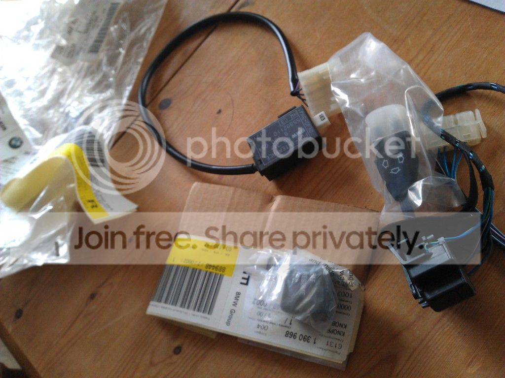

Well another thing has been ticked off the list. After seeing a thread some time ago about how easy it was to retrofit cruise control to an S54 I finally got round to giving it a try. Popped into my local BMW dealership on thursday afternoon and ordered the same three parts outlined by other members:
B61.31.8.360.926 Switch
B61.31.1.390.968 Knob (English)
B65.71.8.380.054 Interface
I got a text this morning saying the parts had arrived:

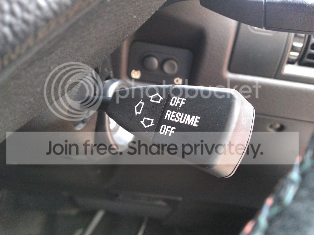

Well an hour or so later its all fitted and working. I cannot believe how easy it was to fit, all the connections were already there, even the hole to cut out was outlined (a bit like airfix models). I've taken it for a test drive and everything looks in working order so very happy
fitted:
