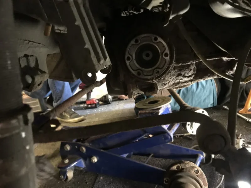

Car raised and the work begins (that work includes swearing, getting covered in amazing amounts of rust, having a laugh and a bit of pain - it’s takes some seriously clever manoeuvring to get the diff out when you don’t have a saggy subframe!):
Extension on extension on extension on extension...you get the idea!:
Gaz thinking ‘how the hell have I ended up back under this old shed?!’:

The pile of bits that that came off kept growing...
Comment on the BC and poly bushes after 4yrs - the springs are rusty and this year the coating has come off them but the shocks are still good and leak free which is more than I can say for other coil overs I’ve had, still very happy with the BC kit and will give the springs some attention.
The poly bushes are as good as the day they went in and despite worries / internet talk that they would cause the diff mount to fail that has not been the case I’m pleased to report.
The car is getting very crusty under there so needs some love under the bodywork this winter...
