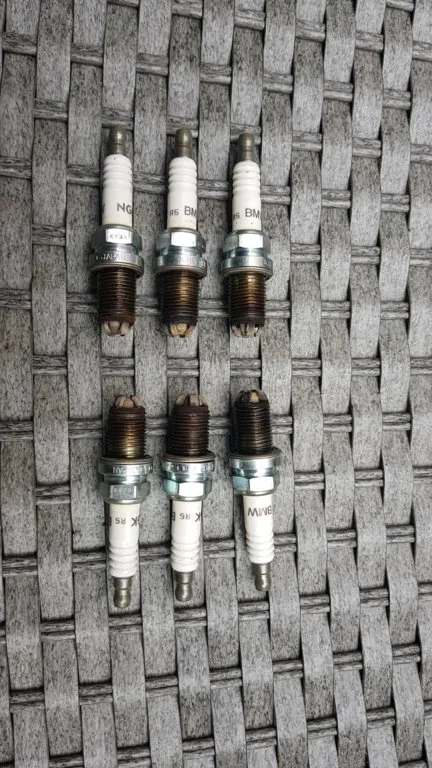

- Changed the spark plugs. From the very little service history I have for the car I believe it was last done in 2007 when the car was on 40,536 miles. It's now on 63,450. The existing plugs were NGK R5 spark plugs and changed to Bosch Super Plus FGR7DQP+.
From what I can tell I don't think there's anything alarming that jumps out when looking at the old plugs.

Thank you. I'm still unsure as to whether the old spark plugs look as they should, can anyone enlighten me?
They look a very good colour to me.
That's great thanks. I know that it's possible to identify problems from any oil etc on the spark plugs. I just wasn't sure how dark normal working plugs can get.
As a general guide if they are black and sooty looking the car is running too rich, if they are clean and very white/grey the car is running too weak, if they are black and oily looking you are burning oil probably due to bore or piston ring trouble or valve guide wear. Yours look to be spot on being grey with a hint of brown suggesting that all is good. Happy days.

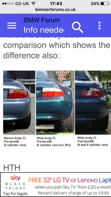

Thank you :) As far as I'm aware the 3.0i is the same as the 2.8i widebody but the newer facelift version.
I think the only 'real' widebody is on the Z3M and the pre-facelift 2.8, which strike me as kind of 911 in there widebody styling.
