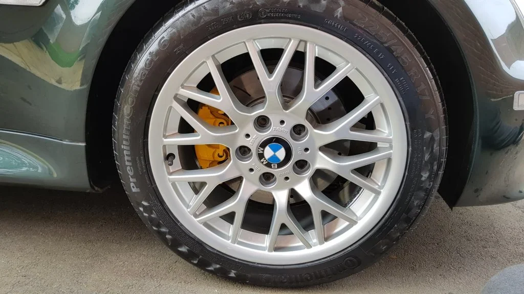

Managed to finally get hold of a set of Style 78 wheels thanks to @Brian H.
I'm not a massive fan of the shadow chrome so I've dropped them off at my local Lepsons to get them back to a nice shiny silver ready for some new rubber.

Got new tyres fitted to the newly refurbished wheels today. I decided to go for the Continental Premium Contact 6. 225/45 R17 91Y on the front and 245/40 R17 91Y on the rear. Once I've put them on I'll probably look into fitting some spacers aswell. Possibly 10mm and 15mm but will have to check.

Look forward to seeing the pics mate, looks much nicer I think.:)
