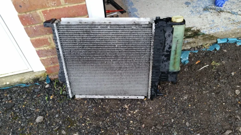

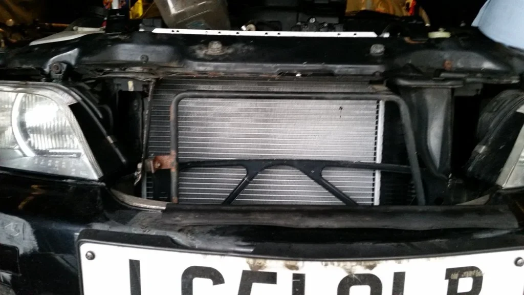

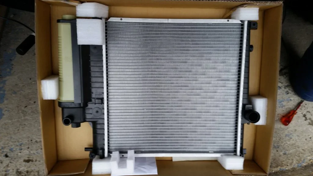

Fitted a new radiator a few days back, had a leak somewhere but could not locate it, tried just the expansion tank but that did not resolve it so went for some new shiny bits. I suspect the coolant was very weak, it had sat for 5 years and how long before that i don't know when it was changed.

Shiny things
Now , im not too sure if I still have further issues with the coolant side, the system seems to pressurize a lot and then blow out the rad cap. Just fitted a new cap and am in the process of trying to bleed the system further to see if there are any air gaps, i Did flush the engine out and some gunk came out which im thinking may have been something like rad weld etc.
I do wonder if the thermostat is gunked up or stuck, its not too expensive to change so i think im going to try that next.
Lets just hope its not a major issue like the head gasket.
