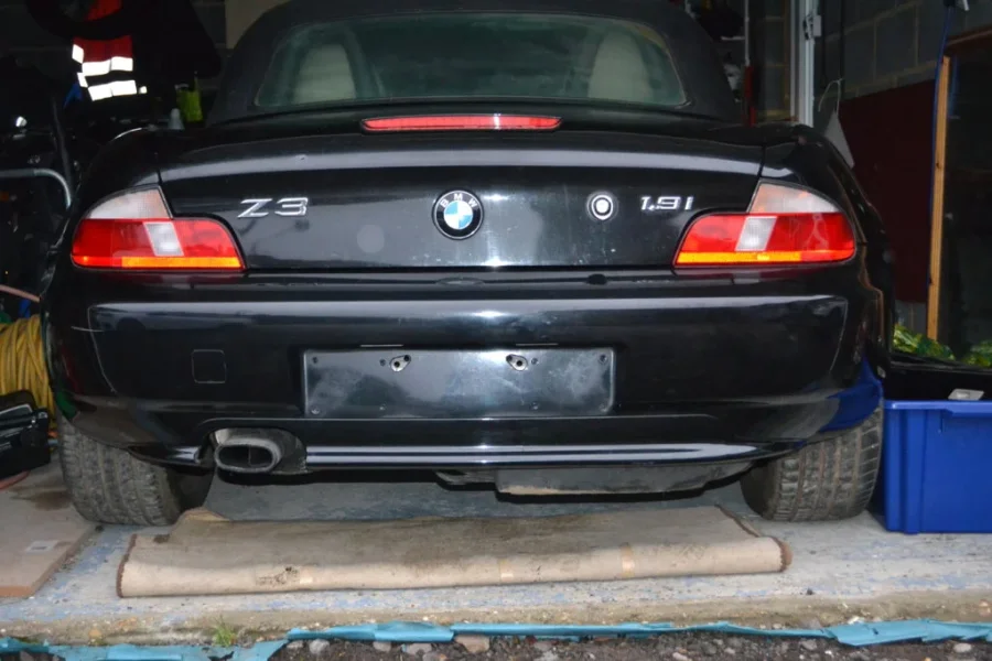

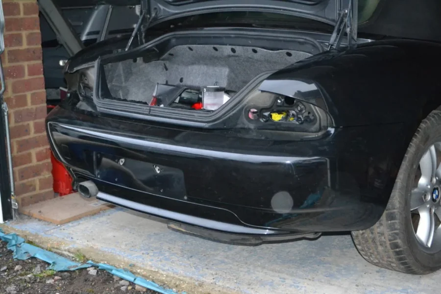

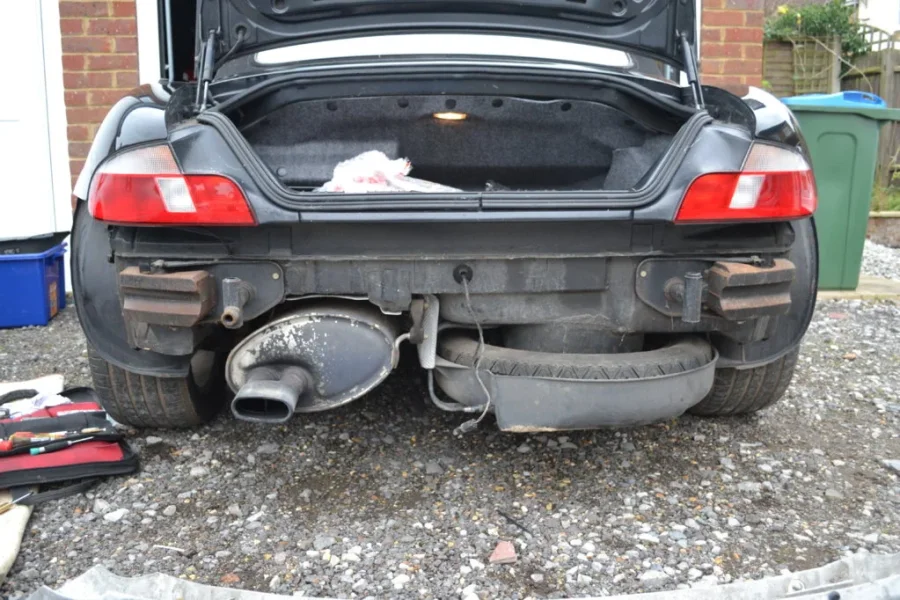

Rear bumper removal today -
Unfortunately the rear bumper plastic cover has a large gouge out of it and many of the little holes the plastic rivets go into are also broken. This I believe will take an a lot of work, time and probably money to repair to get it looking only semi decent - Fortunately I have spoken to Andy ( spurs fan in a coupe) who has one in my color which I hope to go and look at this weekend.
As for removal, unfortunately I was unable to take many photos as I was taking it off on my own, the drivers side was hanging down lose where the previous owner had started to take it off. Again research on here at the Wiki pages and the web I was able to find several ways of taking it off. Again this was a quite straight forward job, but i think fitting a new bumper on will be a two person job.

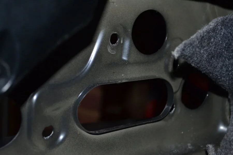

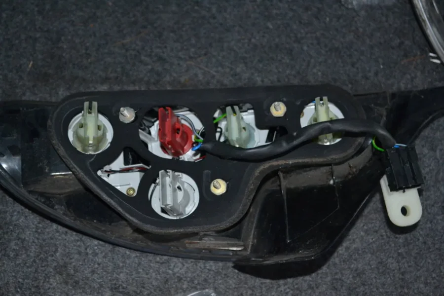

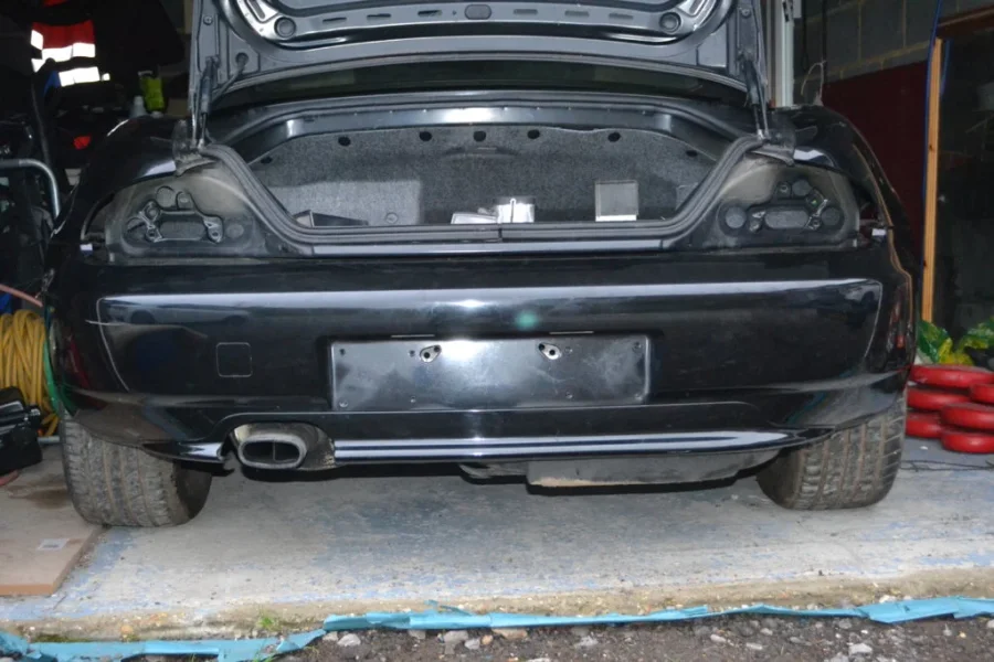

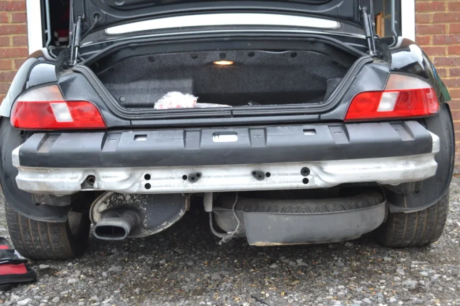

The bumper came off easily doing it on my own, putting it back on unaided is a little harder.
I tried but i just couldnt manage to line everything up, I read on here that taking the rear light clusterrs out made it a lot easier to fit.
Again another straightforward job, 3 nuts and a plug per side. 5 minutes to remove each side max

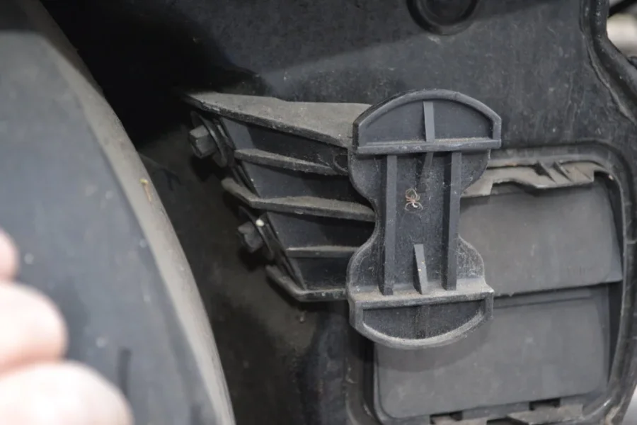

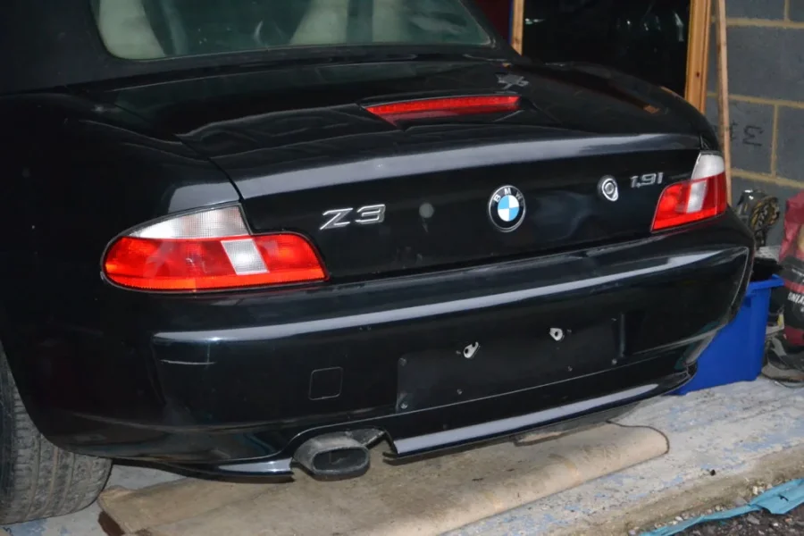

Wow how much easier that made it, the bumper fitted on first time. I really do think its worth taking the lights out first if anyone else replaces their bumper.
The bumper lines up quite well, the gaps are pretty even, but I will be spending some more time later trying to get them spot on.

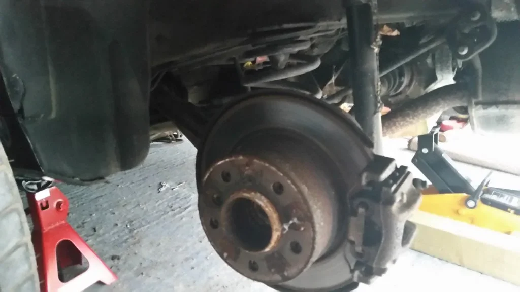

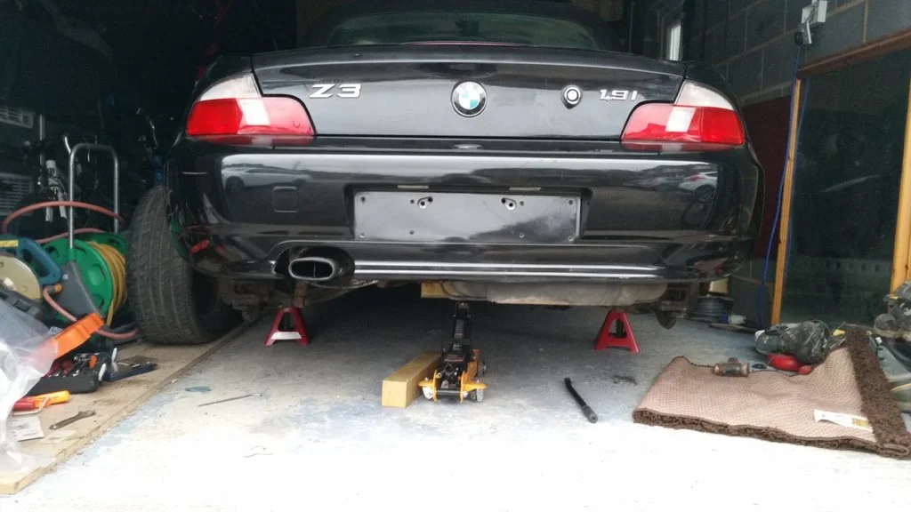

Quick update on progress.
I have managed to temporarily repair my of O/S headlight, a bit of fine mesh and plastic welding will hopefully hold together to get me through the Mot and last till I can get some angel eyes later in the year.
Changed oil, filters ect at the weekend.
Got a coolant leak which I'm hoping is just the expansion tank, but its hard to see untill I pull it all out, £13 new so one on order.
Fun bit today- two new tyres needed due to cracks where the car stood for 5 years.
Could I find the locking wheel nut, had it 4 weeks ago, used it and thought i had put it back in the holder. Checked along the road and drive Spent 3 hrs looking for it in house and garage nowhere :banghead::banghead::banghead:
Spoke to local bmw specialist and he said I would have to try to get a replacement from bmw somehow.but they could only do if I took the car to them.
So how to remove without a key - Good old Youtube, 23mm bi hexagonal socket whacked on and off they came luckily, only for my mum to walk 25meters down the road to find the blasted wheel key in the gutter:whistle::facepalm:

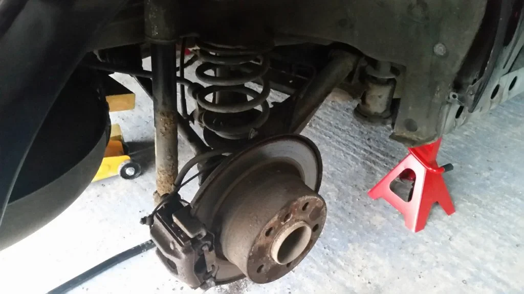

So , the cars now up on axle stands with the wheels off ready for new rubber to be fitted.
Next will be draining the old fuel out and replacing the fuel filter.tomorrow.
i hope to strip and clean the break calipers as well whilst the wheels are off.
lets hope I dont misplace anything else....
