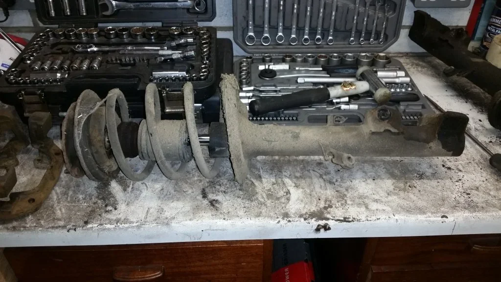

Picture 1. Duncan had supplied some shorter front shock absorbers, and this picture shows the height difference between the two. His original springs were fitted to the shorter shock. Original shock on the right, and shortened on the left - to the eye looks to be around the 20-25mm mark.

Picture 2. From left to right. Factory fitted 2.2 Sport shock absorber - Blues shortened shock absorber - Blues original shock absorber. This picture gives a really unique look at the difference in heights between them. (The 2.2 shock may have sunk a little while it was waiting for me to take the picture already!)
