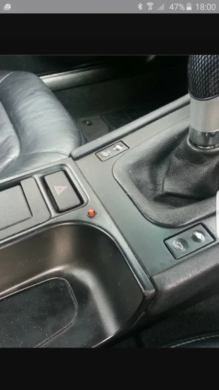

? its just a small raised red protruding light, how does one press it ?

Morning
I have been into my garage and tried to see what happens if I press either the red light or the black surround but nothing it is solid but the light does give a very short light when ignition is either turned on or off, so maybe that means that there is life in the alarm battery but I don't know how the alarm is turned on/off only with the small key that you use under the bonnet on alarm.

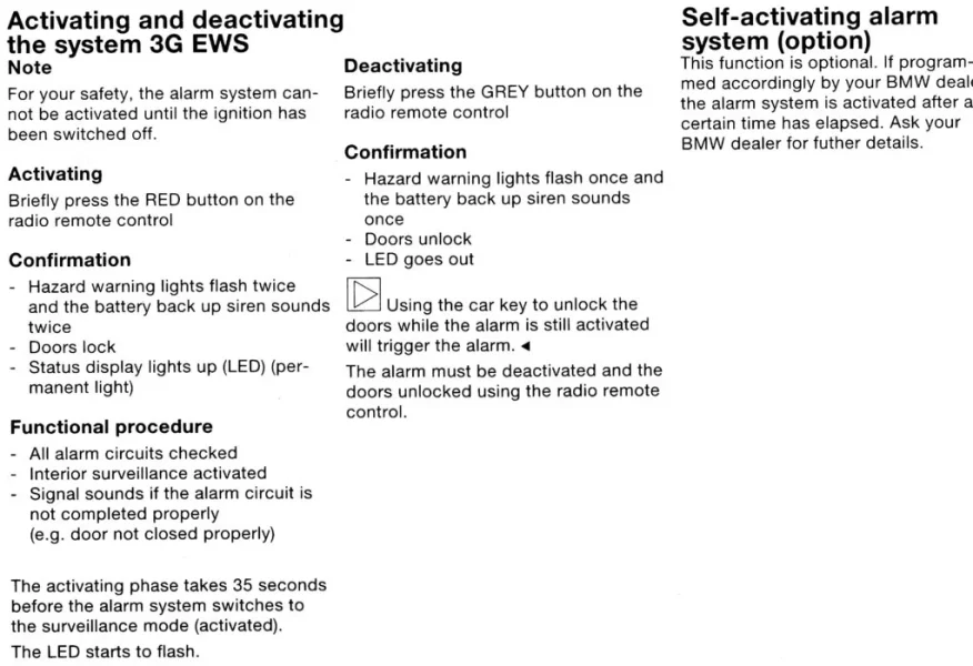

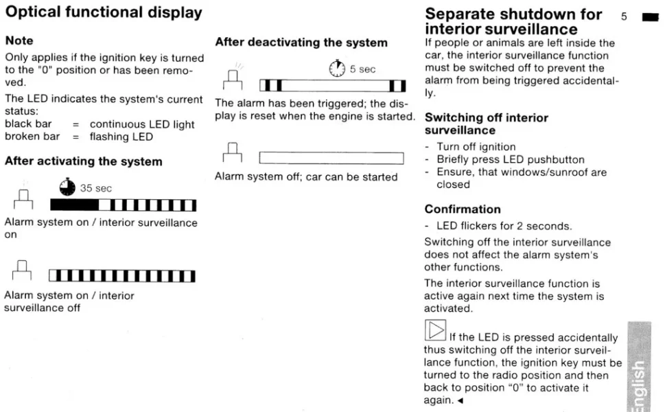

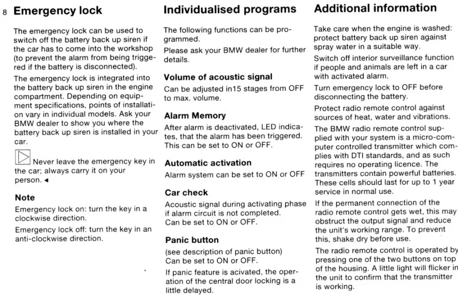

Have a read of these extracts from manual - they should explain sufficiently
Page 4 - Activating-deactivating.jpg Page 5 - Optical Functional display.jpg Page 8 - Emergency Lock and other.jpg
View attachment 27712 View attachment 27713 View attachment 27714

Under Optical Functional Display (where is this ?) it states that if the LED is pressed accidently thus switching off the interior surveillance etc. etc. do they mean the small red light if so mine is ridged ?

The extracts I attached were from the Supplementary manual 11/97 print. If you have a later model there may be some minor differences as @Antm72 has suggested.
Optical Functional display is a fancy way of saying LED. On the version referred to in the extracts the LED incorporates a spring loaded button which when depressed sends a pulse signal to the control box and then returns to its original position. It is not uncommon for the button to fail and the spring flies out (been there got the tee shirt). If yours is rigid then it may well be the spring is missing.

Thanks Althulas I have added this to my Ebay watch list and from the pic of it I can see the spring. I will see if I can remove my light and check out the spring which has either brokem or got stuck.
