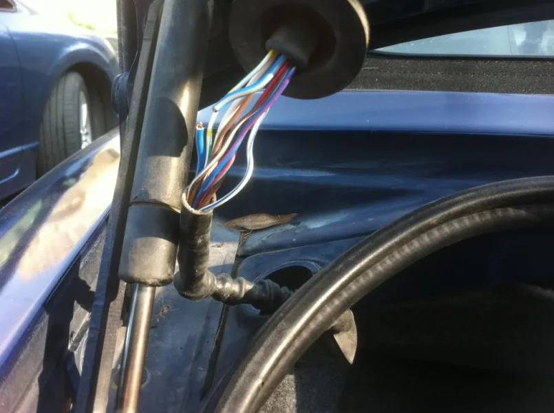

@Geoff Crispin - you appear to have a few things going on if I read your account correctly - if I've read it wrong - apologies.
Intermittent lock performance is usually associated with a breakdown of some of the cables where the wiring loom in the boot leaves the car body and enters the boot lid - it is commonly referred to as the `loom of doom'. It can cause all sorts of strange events. There are a few photos on the forum but I can't find them at the present. It can also be a faulty door solenoid but I would start with boot wiring check.
The siren is part of the remote locking system. It will not sound from the key operated central locking.
The siren has an internal back-up battery - so if you disconnect main battery you should hear it sound as it runs down. If you decide to check siren this way then before you disconnect make sure you have your radio security code - you will need this to reset radio on reconnection. HTH

However, if you have a wiring loom fault this could drain battery as well. I suffered with erratic flat battery and door locking until I found and fixed boot loom failure - once done no further problems with either. Sometimes fault will blow fuse but in my case it didn't. You should check your alarm system fuses once you have your fob.
