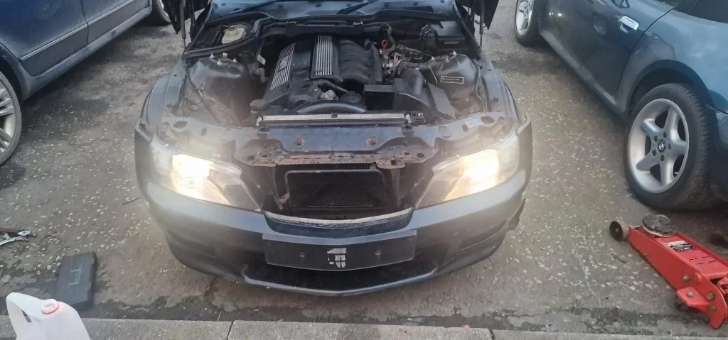

After @Stevo7682 stripped back the front end, the main damage to the vehicle is to the support arms which house the crash bar shock absorbers. The drivers side support had kinked around 10mm inwards.
After some pushing and pulling....
Just a mock up but looks more like it used to. Seems to be lining up OK but the bonnet is a mess. It could be bent and usable again but I'm going look out for a replacement, then think of a plan.
Feels better looking closer to drivable condition. I've not peaked underneath yet. I know I'm going to be miffed but it's done.
There is more damage to deal with but we'll leave that for a later update.
She's alive. Her heart beats again.
Stevo had some time to plumb the cooling back in and get it running. Engine is running fine. There was a chance it would never get this far.
