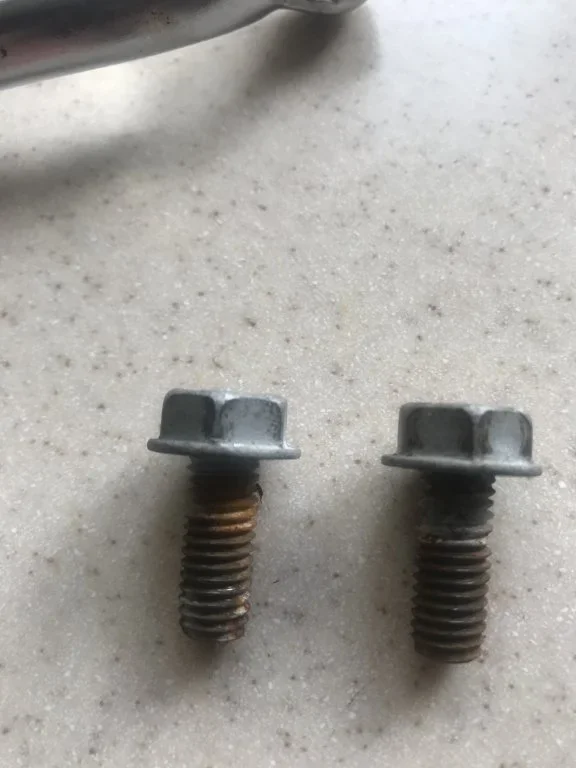

Two reasons…. Loads of rusty s*** in the bore!! And the bumper bolts have been over tightened, which has expanded the insert.
NOT a problem , when you have a mate with a state of the art lathe in his shed:whistle: who will tidy up the O/D so it fits properly.
Cleaned up the two M27 threads in the bumper mounts with a tap ( bought when I had a problem with the 1.9………. ok …….I smacked it and had to rebuild the front:whistle:=))

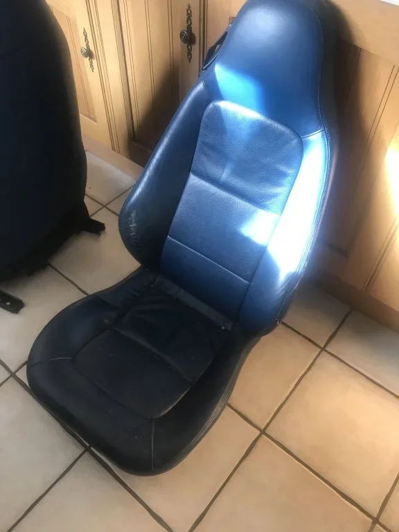

the seats have been in the shed … and looks like they had suffered !! Rust !!! And Mould :arghh:
So it has to be done sometime so brought them in
Found a bit of damage so will need to sort a repair of some sort :whistle:

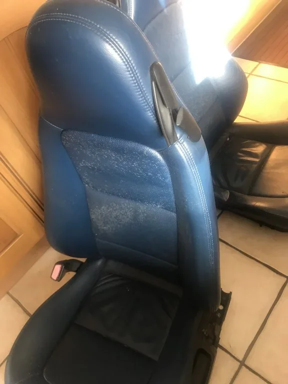

The seats needed a clean…
so about 20 min later….
So what expensive state of the art
did I use?? Autoglym?? no…..,
A bit of colour restoration needed but I have some stuff that will hopefully improve this ..
Letting it dry over night (indoors) before doing anything more!!!!

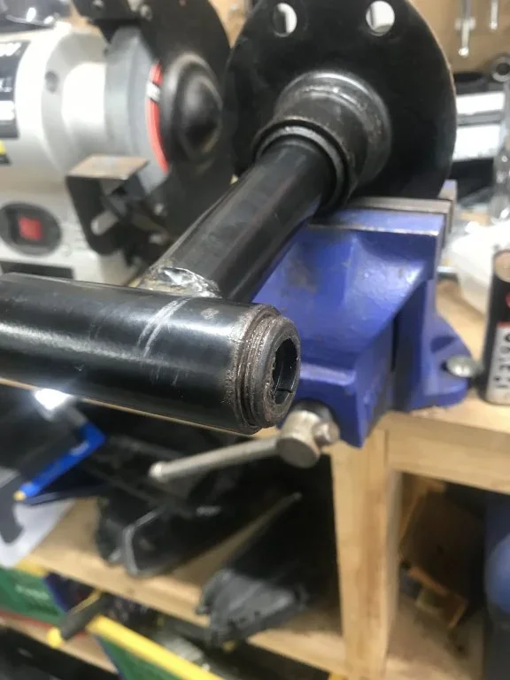

So had a closer look at the bumper inserts and it looked as if the problem was a build up of rust…. On both the bumper supports and the salvaged inserts.
So armed with these….
Dremel with extension and little grinding wheel, and a 25mm flapwheel, I set about derusting both parts…..an hour and half later I had one covered in antiseize copper grease and working as it should.
They push in from the thread end… and the the last bit screws in. You use a 14mm hex from the bottom normally, but it just screwed in using my fingers
One down one to go….
You can see the build up of rust in the bore
Which is why they didnt work and there was never any chance of removing them in the normal way……

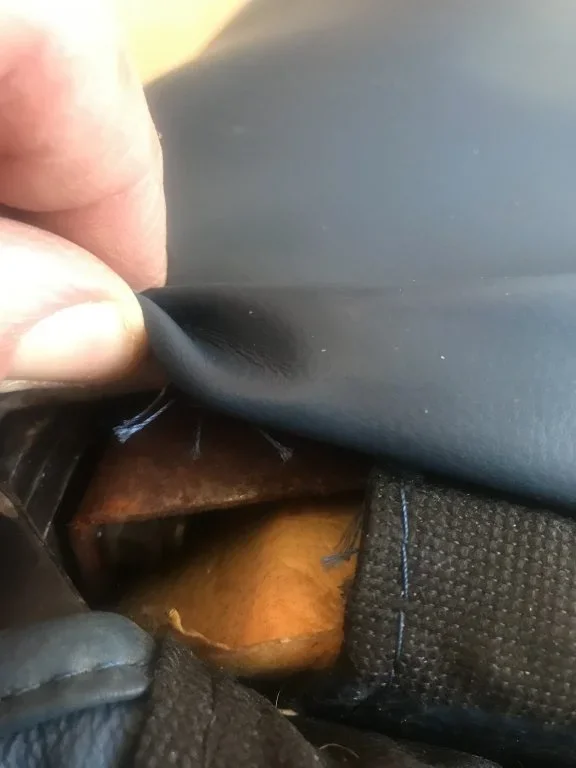

and found this …..
The seat occupancy membrane. But don't think it works as it wasn't connected, and there was another dummy plug in the unit where it should plug into????

...The seat occupancy membrane. But don't think it works as it wasn't connected, and there was another dummy plug in the unit where it should plug into????...
Yes Malc. As the seat occupancy sensor mat was [probably] open circuit, the air bag self test would fail and illuminate the air bag light on the dash. The dummy plug simulates the sensor mat so the air bag light doesn't illuminate. It does mean that in the event of an accident the passenger air bag will go off even if there is no one sitting in the passenger seat. HTH
@Mint Should there be a circuit if I buzz out the connector?
If not ....might as well remove it as it is not actually doing anything =))
Testing towards the mat should show some resistance. No idea what it should be but if it's open circuit it's definitely dead and why there is the dummy plug there;)
